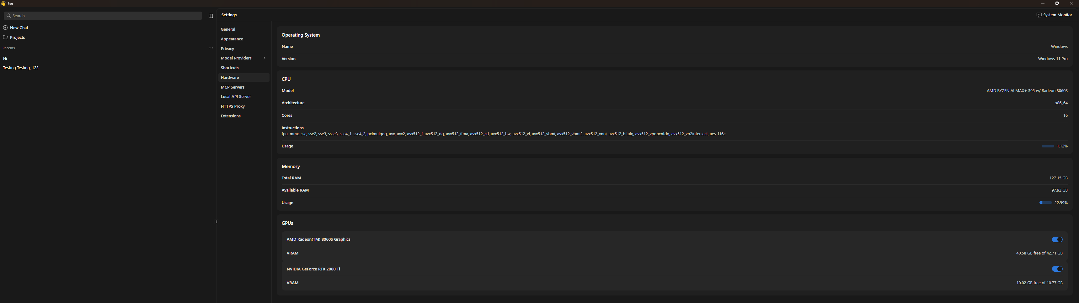

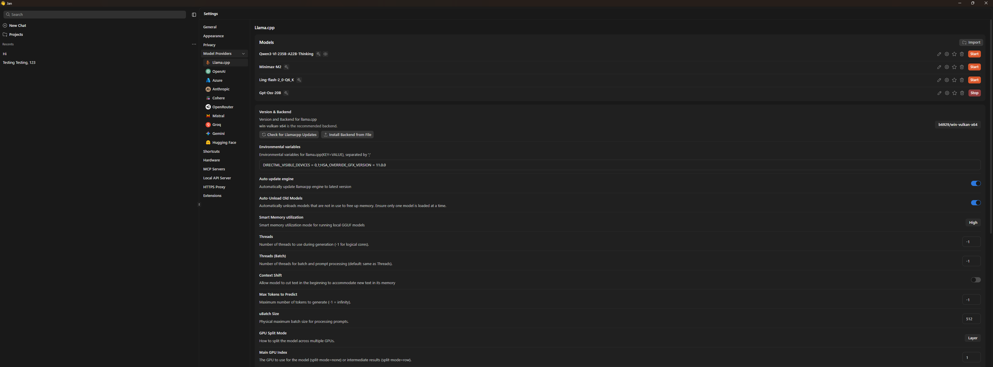

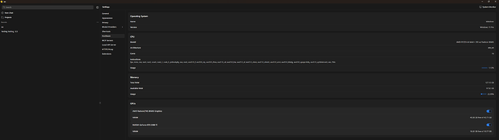

So, an update…
I have had some small success in Jan.ai!!
Both GPU’s are visible, and “seem” to work in parallel (both gpu’s in Task Manager show utilisation) but still breaks with models over the GPU ram limit size i.e. if I load to the 2080ti first, then it goes bang… but fine if I load to the 8060S iGPU first…
