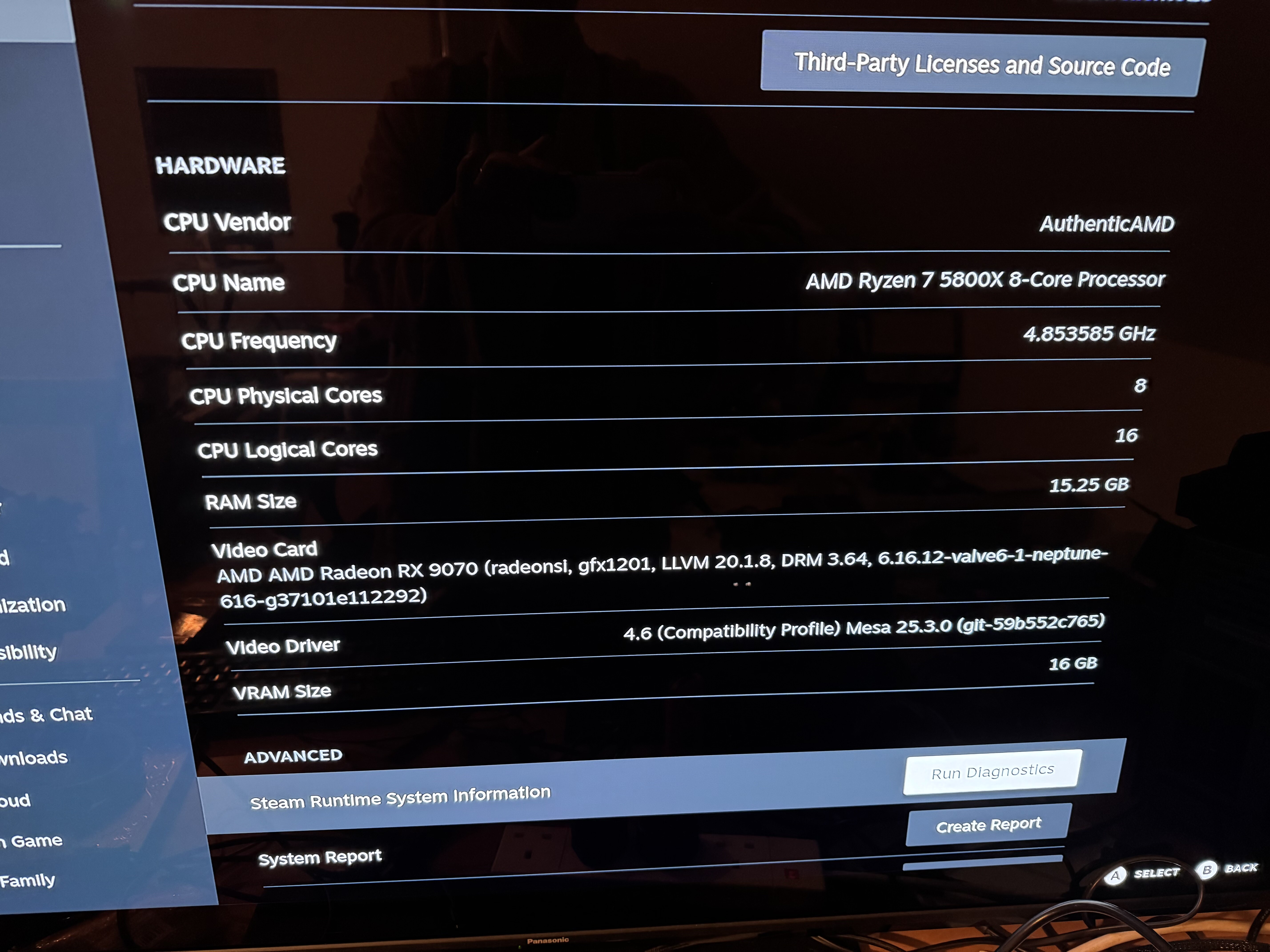

Following this guide, and got the Rx 9070 working in native Steam OS.
