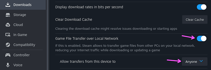

Steam download-sharing has now made that somewhat obsolete for small events where you can ask people to turn that on.
