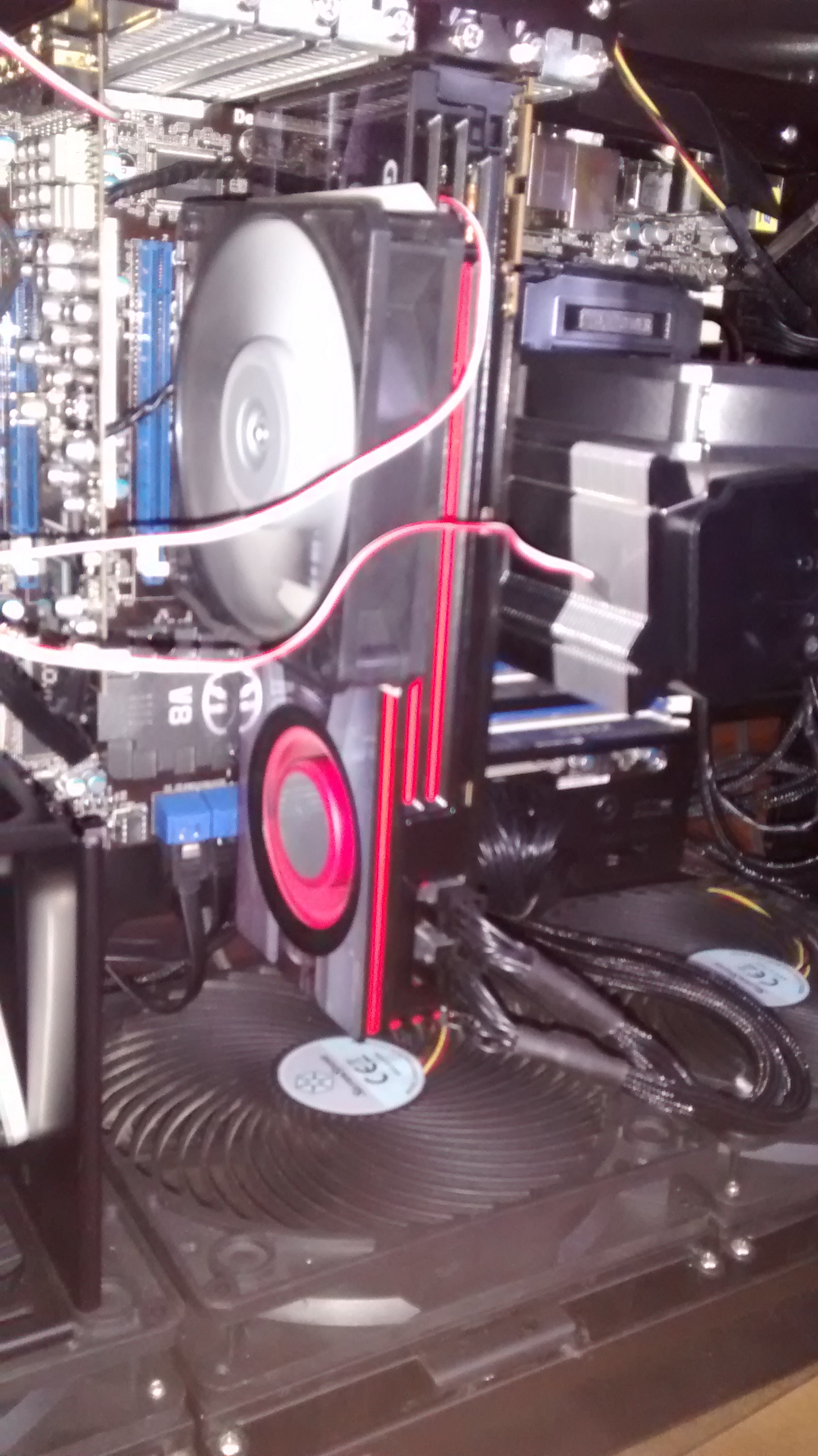

Here's a picture of how it looks(sorry for potato camera):
Imgur
As you can see the bottom ap fan is blowing air all around the card,
In idle it sits around 55-65 celcius, but it can have to do about my fan curve, which is set to 22 speed up to 80 degrees, then it will ramp up.
But as I said, I don't care about the sound when gaming, only idling is important.
Ah ha, FT02-B?
Well that center fan should be on max, and if you're still idling at 55 it's time to remove the heatsink in its entirety and reapply thermal paste. I crammed three of those cards together and even the middle card was only idling at 43C.
Also that extra fan isn't doing much for the card by being on the plastic. You would want it blowing across the PCB.

Yeah, I've even lowerd the ap fans with a fan controller, so they are just around 550 rpm.
The fan on the shroud, doesn't do much, that's true, but it actually lowerd the temperature a few degrees.

Increase the right side AP fan speed to 800RPM at least. It'll help clear the hot zone between the GPU PCB and the CPU heatsink.
