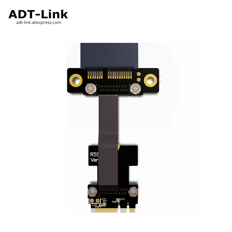

I think the issue is he finds plenty of m.2 to pcie adapters but they are all straigh on the m.2 side but 90degree on the pcie side.
this is the closest I have found, doesnt meet the need tho

No, I mentioned you can double up on adapters.
First get this:
Then this:
I believe the M.2 cable is shielded too.
@mutation666 THAT’s exactly what i’m looking for! Thank you! A wee bit short, but THAT! However, Amazon, in their infinite wisdom decided to “This item does not ship to Germany”. sigh (Germany is where i’d want it to ship to.)

You can choose the length of the M.2 cable on the AliExpress page, so I think that’s the solution right there.
