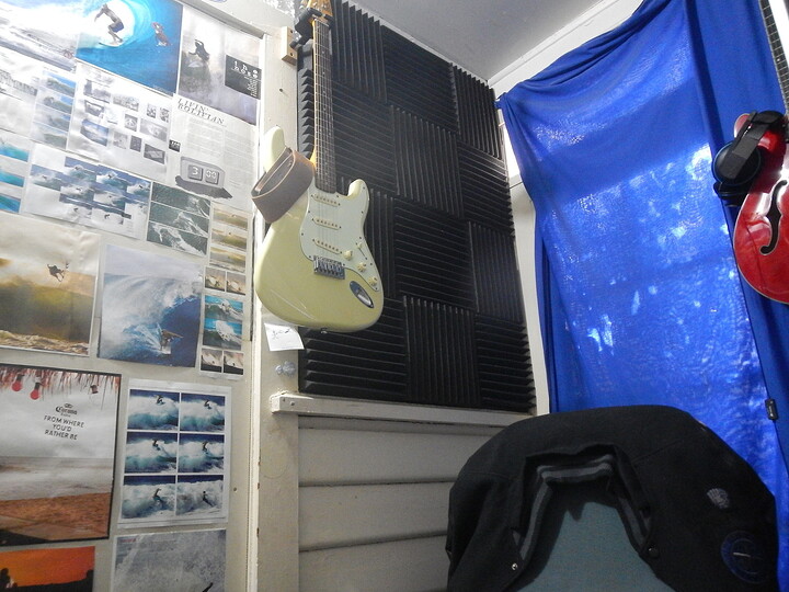

Here’s a quick update on what I’ve done so far, pretty simple stuff with the hot glue gun. Plan to do the bottom half and also line the border of that wall that has all the pictures on it. It’s done quite a bit to stop voices and keystrokes coming through. Will try another sound test when it’s night time :slight_smile:
Yes that is a blue sheet being used as a ghetto curtain haha.
