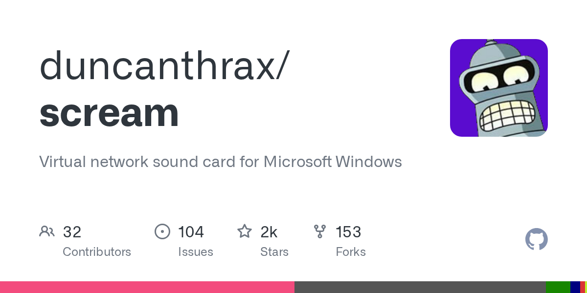

I would then probably look for ways to stream the audio over the network, from the VM to the client somehow. And connect the sound device in the client. That would imply a second network stream in addition to RDP, but at least it would be a software solution.
Scream might work?
