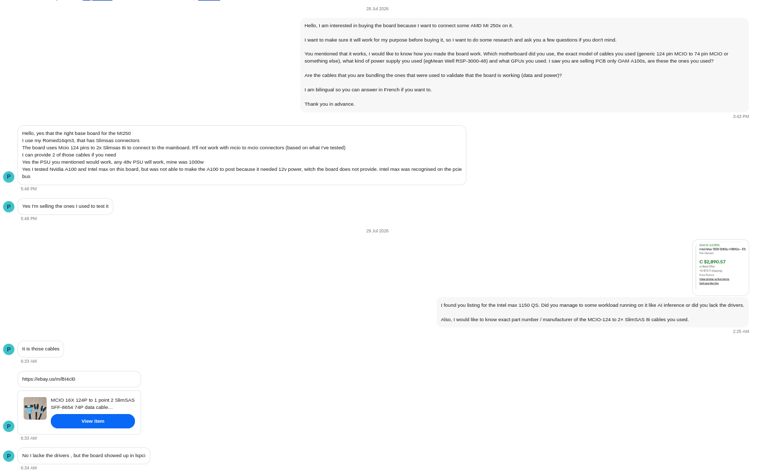

Thought I would share one of the conversations I had with a seller for a AOM-MCM-Q, which I was about to buy, but I was a bit too late.
It confirms that the AOM-MCM-Q can run a GPU, just not the mi 250x, yet…

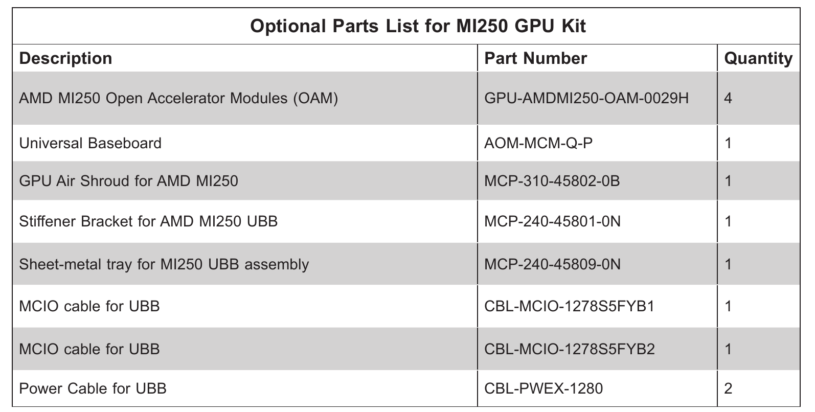

Yeah I’ve wondered about that connector too. It’s present on the H12DGQ-NT6 as well, but there’s no listed connector cable for it in the parts list from the server’s manual.
One thing worth ensuring if you pick up the AOM-MCM-Q is that it should come with a stiffener bracket, which the seller left out of mine. I’m most likely going to build one.
Here’s the server manual as well:
supermicro-AS-4124GQ-TNMI.pdf (47.5 MB)

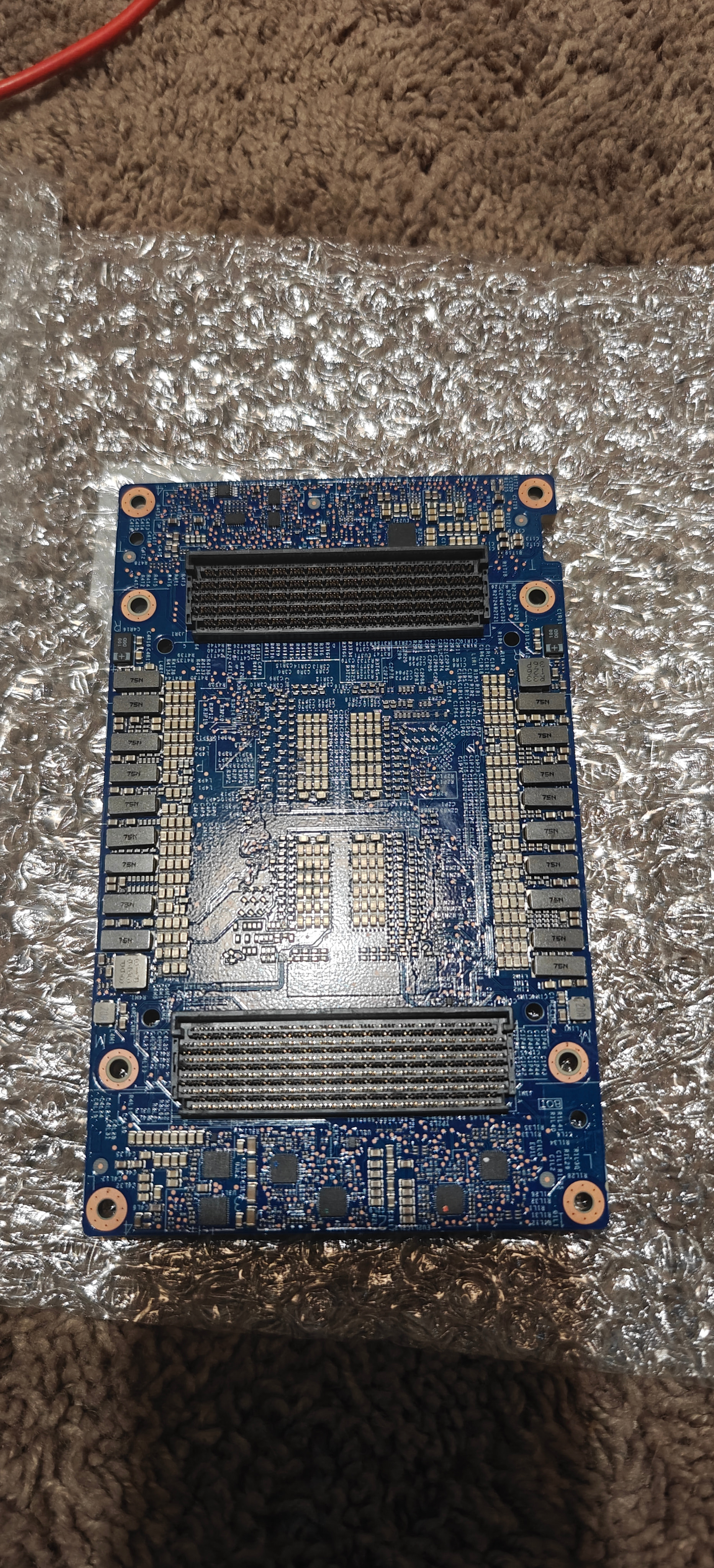

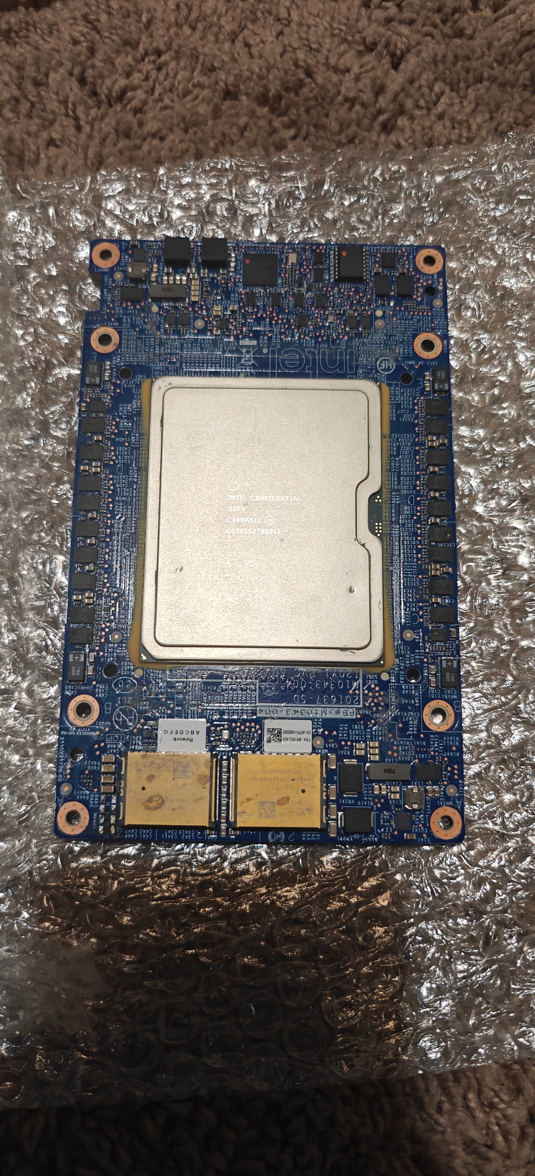

Hey guys, been reading through here, just interested because of OAM, but my card isn’t AMD, I have a Intel data center max 1550 oam card, I’ve been gathering information to best see about getting it to work in my system, which currently has a Intel max 1100 pcie card in it.

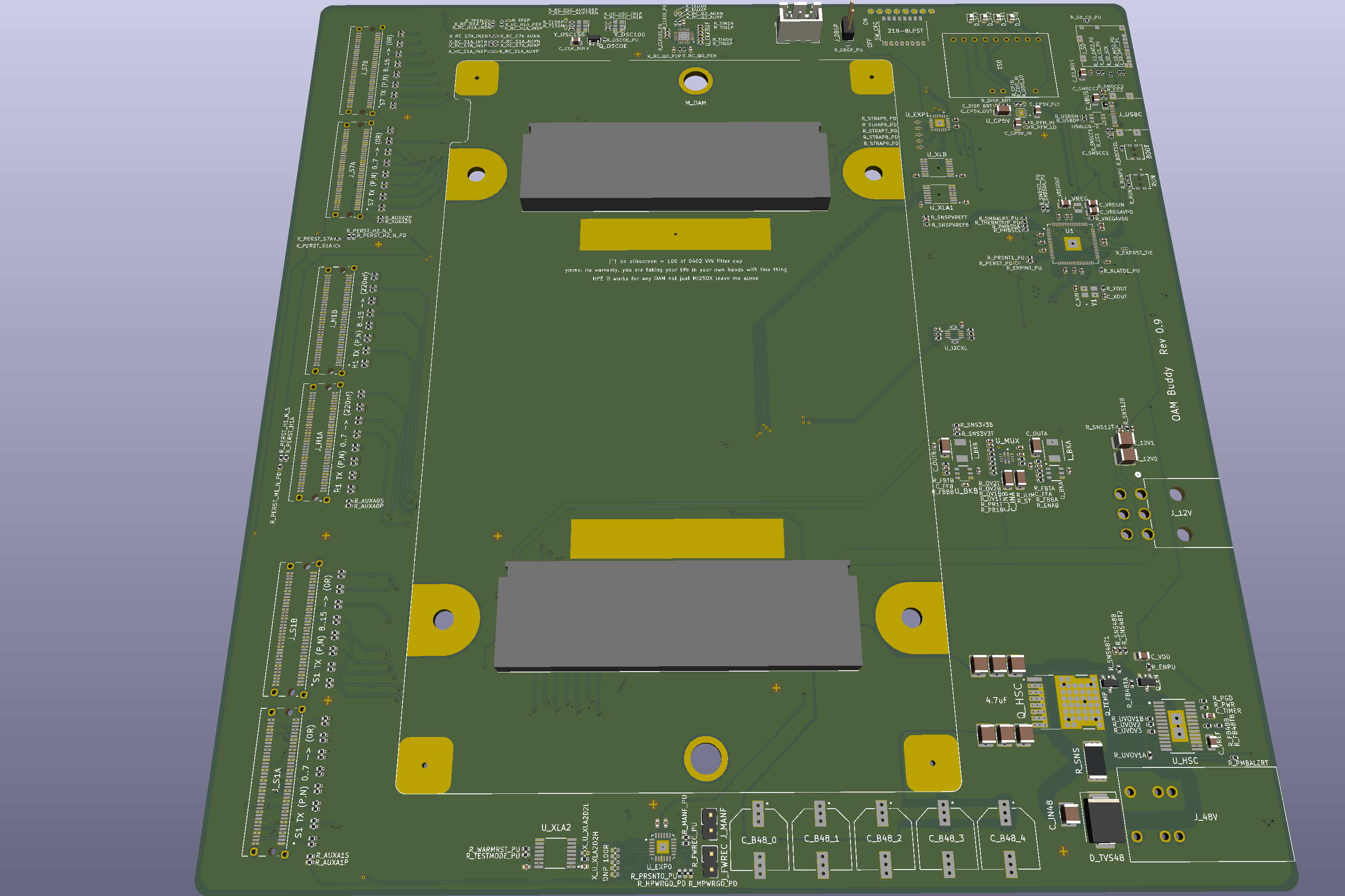

Anyway, yeah, $500 to JLCPCB later, I have a board on the way (well, five boards because that’s the minimum order quantity). ETA 2ish weeks since it’s a pretty complicated one to manufacture, then assembly (I have a little reflow oven in my garage). It’s a mini 1-oam dev baseboard - it wires up all the diagnostic and debug ports from the module through a microcontroller so that I can experiment with the various side channels in a way the commercial ones can’t. Implements the full OCP OAM spec for module management.
I have a hopeful running theory on how to get it working - I think there’s a way to put the modules into a recovery mode then sideband the firmware through the SMBus. As far as the psp - it checks for AMD signed blobs, but that’s exactly what I intend to use. The OAM recovery sequence state machine requires the firmware be signed, but in recovery mode it’s checked at next boot.
So the board has an SD card slot and my hope is that I can drop an official but working firmware on there, then sidechannel load it onto a module.
Am I 100% sure? Hell no. I could not in good conscience tell anyone to run out and buy them. But my confidence is high enough I bought myself three more after doing my work tearing down the first one.

lol i think i know you. you’re the guy that bought an intel max 1550 QS/ES on eday right. apparently it was working on a AOM-MCM-Q.
well good luck with that because this is something completely different. i doubt anyone here will try to hack the firmware or/and drivers to get a one off working.

There are two OAM to MCIO designs being worked on as far as i know, but they are both for the v1 version of OAM, while your GPU uses the v2 version.

According to Intel press release it should be oam 1.1v, but yeah I’m not sure if either one would work either. Intel stuck pretty closely to the OCP OAM standard so I guess I’m going to pick up a OAM to pcie carrier and get to work on getting it going. But I shouldn’t have to much of an issue with it, my current Intel max 1100 I have running is an ES/QS model.
