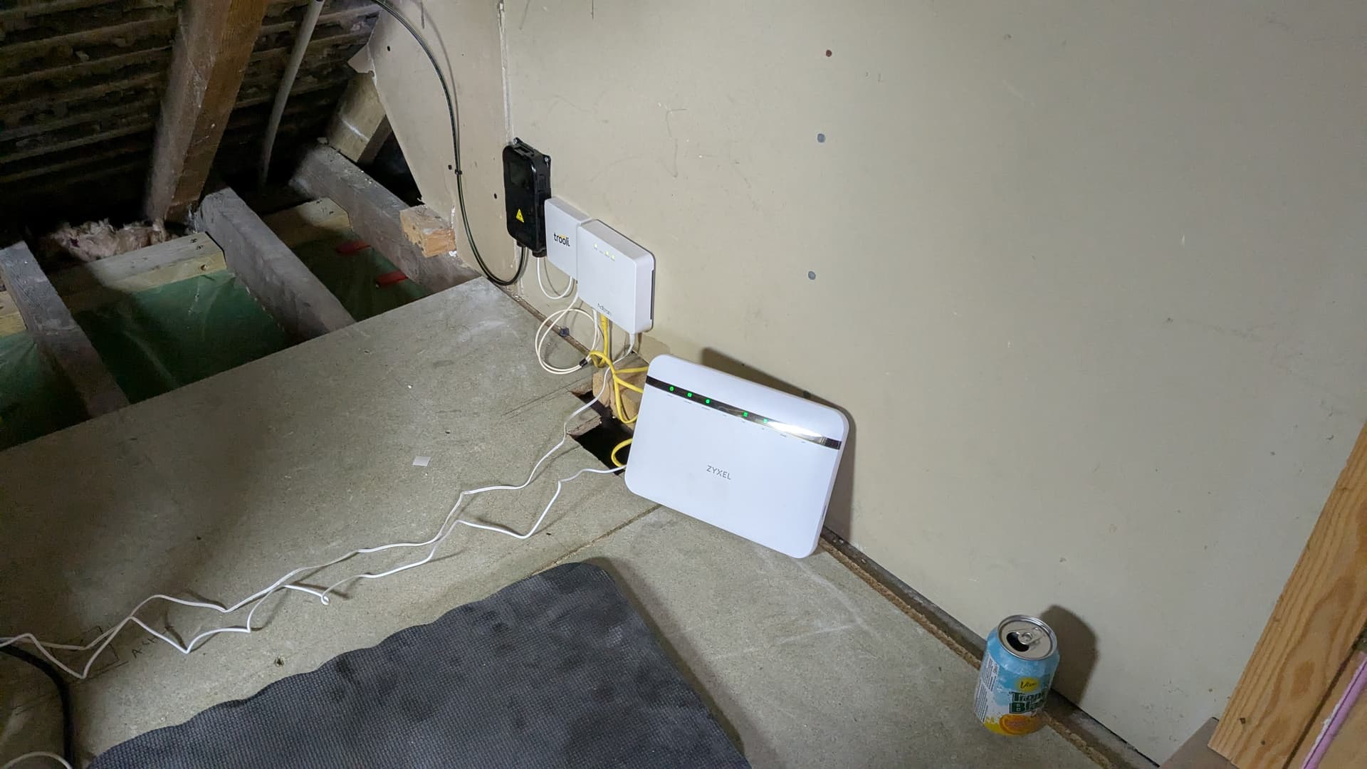

So to go through it all again, I didn’t really want an ISP router cluttering up the downstairs of my relatively compact house and instead preferred it going straight into the loft. I’m planning to condition** the loft at some point, so heat/cold should be less of an issue. Most of my network gear is up there and it’s done well in the heat, though I do have a fan blowing at all times to keep the worst of the heat away from the switch and various bits.
INSTALLATION AND NORMAL WAY ITS DONE
The Trooli engineer seemed to appreciate the idea of going into the loft - after all it’s less invasive and I’d pre drilled a hole in the soffit and put a conduit in with a draw string. The standard method is to
  • attach the line coming to the house, at high level on the fascia board,
  • run it down to the ground floor wall
  • drill through the external wall
  • put a junction box on
  • connect through to the internal room
  • fit the other sockets and plug the router in.
PHOTOS AND DESCRIPTION

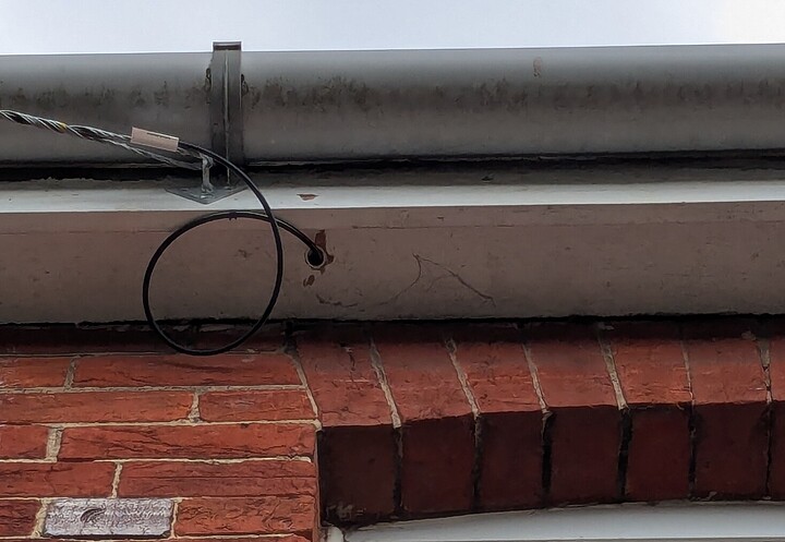

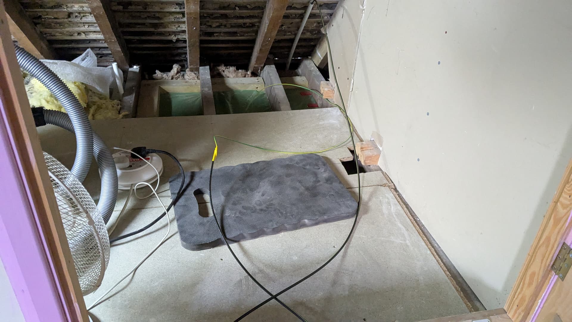

Here’s what I did on the outside, you can see where he’s pulled the cable through the conduit I installed
Meanwhile on the inside I tidied up the area he’d be working in, put a fan in there and a knee pad, cos I try to be considerate when someone’s working in my house. When I go to other people’s house, they sometimes show some consideration and don’t treat me like a nuisance in their day! You can see the yellow/green line I put in, along with his cable taped to the end of it.
And voila, he’s put it all in.
And the results :slight_smile:

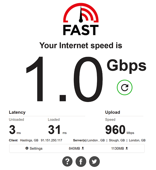

My original speed was around 70Mbps…so that’s nice! I have seen 1.1Gbps at times, funny to think that my 1G network cable could be holding me back :laughing:
I gave it a good few hours, in case they’re doing technical things to improve the connection, line testing, etc. Then I unplugged the cable going to the router and plugged it in to my USG - the cheapest small unit they do.
I thought it would be fun to have 2 WAN’s, but after a lot of playing around, it didn’t really let me turn off one and use the other (only fall over seemed to work, but no evidence). So I unplugged my original ISP (still have 1 month left until I’m out of contract), and popped the new ISP cable into the main WAN port of the USG.

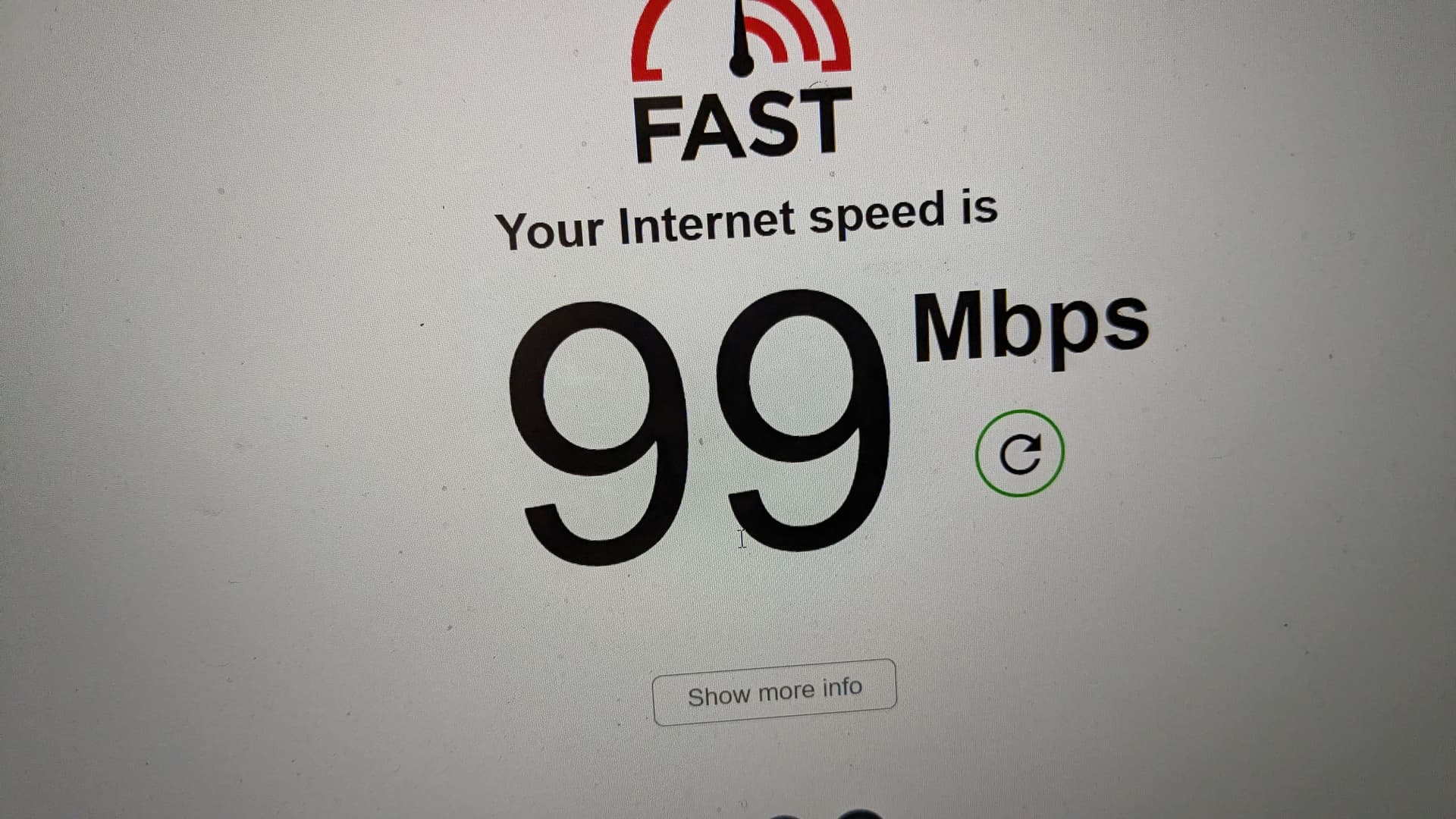

At first it was strange, I was only getting 100Mbps, instead of ten times that.

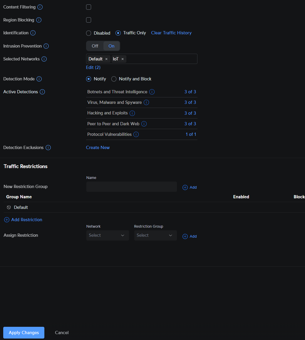

After some fiddling, so far I think it’s the USG’s Intrusion Protection that, when enabled, slows it down. I need to research further, but for the moment I’ll be turning it off (which is a shame), perhaps I need to upgrade the USG if I want to maintain protection.

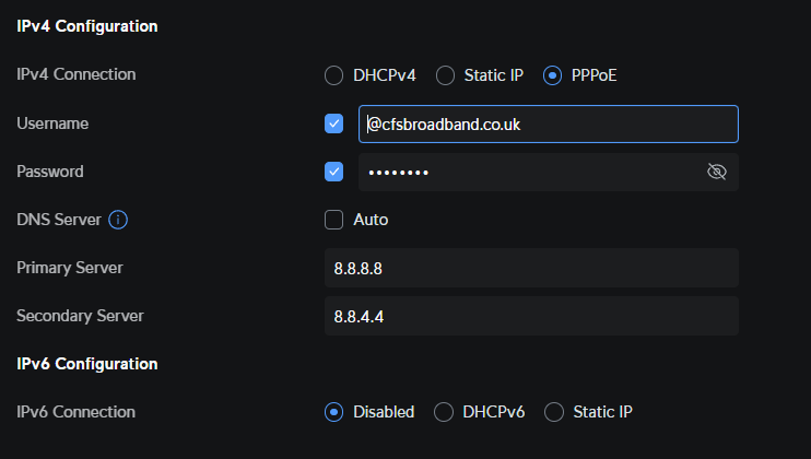

One thing that you need if you’re not using the router supplied by the ISP, is the login details for the fibre connection itself.
Trooli were actually very helpful, I rang them up and as soon as I spoke to sometime and explained, around 10 minutes later I got the details. These are the username
[account number]@cfsbroadband.co.uk
password.
Fill em in here, sorted.
When I was having issues, I briefly turned on IPv6, but it didn’t matter in the end so I left it off.
I’ve since found that the USG I have, alas cannot do protection at anything more than 100Mbps.

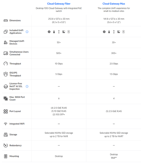

I’ve had a look, and for around £200 I can get a Cloud Gateway Max, that appears to have protection throughput of 1.5Gbps, providing some headroom.

Oooh, I got to do a test upload.
I did uploaded a video to youtube, around the 800-900MB in size.
The old ISP took around 6 minutes, the new one took around 8 seconds :slight_smile:

But what does this protection actually mean? Most of these kinds of devices on the market are more about PR than actual security.
What can a central device actually do in 2025???
A firewall, in other words, basic ingress/egress traffic control at the protocol level, i.e., IP/ports/MAC. There are no magic bullets here, typical traffic control solutions and a few variables for analyzing basic parameters, such as fragmentation. In some cases, the vendor provides a list of IP addresses to block.
Deeper protection, meaning we enter the territory of traffic analysis solutions such as Suricata or Snort. Here, without good, constantly updated rules, we can’t do anything; for this to work, we have to decrypt encrypted traffic. This requires a dedicated certificate on LAN devices, similar to what antivirus software does to scan https.
DNS-level filtering.
All of this can be achieved without paying for a nice box. Most gadgets called NG-Firewalls or other fancy names are usually just a set of a few tools/functions wrapped in pretty paper. Most are more suited to industrial networks that need to expose resources to the world.

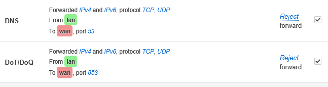

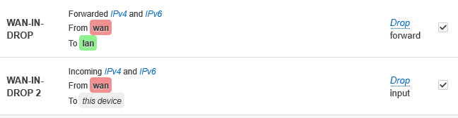

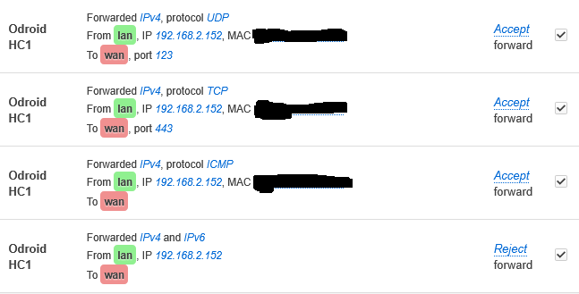

Even simple OpenWRT with its firewall will provide the basics of traffic control. Personally, I implement a strict firewall policy on every device possible. No process is allowed to access the network without my permission. :slight_smile:
Every machine on the LAN must have a set of rules on the central firewall.
I only allow specific traffic and block everything else for each machine.
f5
Traffic from the WAN side is neutered.
f1
Access to the router is blocked, only a dedicated rule for the trusted machine.
f2
DNS traffic blocked, DOH filtered on pihole.
f3
Paranoia plus, central blocking of LAN traffic, if you don’t have a dedicated rule you won’t get out into the world.
f4

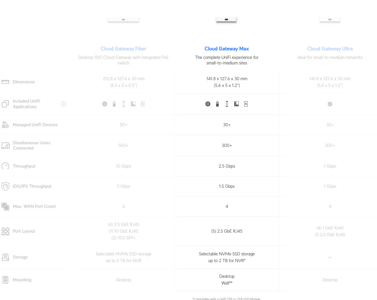

The only UniFi gateways worth buying right now are the Cloud Gateway Fiber, Cloud Gateway Pro Max, and Cloud Gateway Enterprise. Those 3 fill all product segments UniFi targets.
Of those, the Cloud Gateway Fiber is the 1st of a new generation gateway family, and also is the only one to support multi-gigabit PPPoE internet due to its new hardware offloading ability for that type of connection. So if you have that type of internet, which you do, then the UCG-fiber is the only product you should be considering. Officially, U-CGF also supports between 5-7gbps traffic throughput over full Threat Management IPS mode (The notify and block setting). Unofficially, it can run IPS at line rate 10gbps in most cases but UniFi doesnt want to advertise that or it will murder sales of their UDM Pro Max and Enterprise line.
The UniFi Threat Management runs Suricata under the hood and it pulls form Proofpoint’s Emerging Threat Intelligence. The free version is supposed to be updated at least daily, but not with the entire range of threats, only the most common ones. It isn’t the best still, unless you pay for the subscription, but it is a infinitely better than nothing. The paid for version is $99/yr and gets updated with everything and multiple times a day.
And while traffic itself is encrypted, that doesn’t mean packets aren’t scanned. Encrypted traffic doesn’t not mean nothing about the traffic is known, that is a large misconception now days. Encrypted traffic only has the data payload of the packet encrypted, the source and destination must be readable otherwise the packet cannot be routed around the internet to where it needs to go. So by having a full list of known malicious servers you can already block off a ton of IPs and domains various malware reaches out to whether traffic is encrypted or not. The IDS/IPS uses signature based pattern matching to block these known traffic patterns of malware and known C&C servers. It also does full DPI on un-encrypted traffic.
Is it the best? No. But it is still useful and actually does protections of traffic going in and out the firewall. It also inspects inter-VLAN traffic as well, so infected devices can become detected and blocked off even without reaching out to the internet if you have segmented your network.

I’m inclined to get the Max, mostly due to the cost difference between that an the Fiber - £200 vs £325. I saw the spec and thought that it matched my needs - I’m not a network/security engineer for a living, so @OliverT said, I won’t be spending days looking over logs.

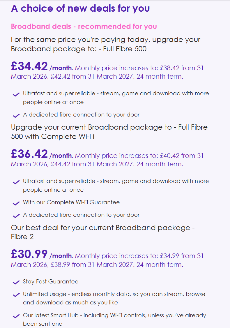

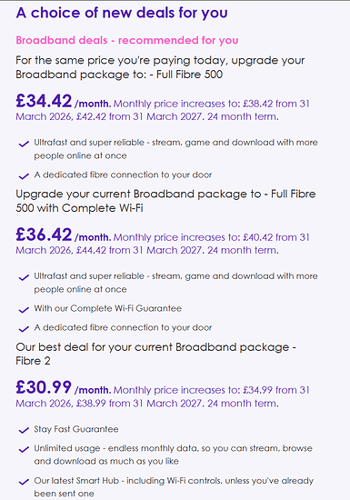

Oh and interested to see BT trying to ‘win’ me back (just a reminder but I’m paying £31 a month for 900Mbps and max line speed appears to be 1150Mbps).
Jeez, that is some Large price increases…
I guess at least they let their potential victims know in advance?
If it meets your needs and you have no plans to go above 2.5gb 1gb on the internet or LAN side until you upgrade the router again then it would be fine to go with the Max and save some money.
Edit: I just remembered that because the Max is one of the gateways from the older generation it doesnt really get above 1-1.5gb throughput on PPPoE internet connections.
Oh, was it less than that a while back?
I think they only make their victims aware BEFORE they enter into a contract, probably less so when they’re already in! :roll_eyes:
Thanks for answering mate :+1: I can’t see any time when I would go over 1, let alone 2.5! I’ll save some pennies and get it at some point, thanks! :+1:
I mean the plan prices with built in 10% rises each year, built into the plan itself.
Not like “£30/month for 2 years, then market rare at that time” like a phone plan or something
