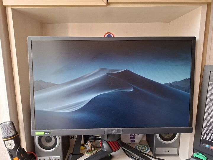

No idea why this happened, but when I used Windows with the passthrough VM, I did not care too much. MacOS on the other hand has does not even video output on the GPU (even eventually).
UEFI on the Windows VM does not output anything, the same goes for the Windows boot manager screen and boot-up screens.
The display turns on when the blue screen of Windows update appears in any shape or form.
I cannot use macOS because of this, and it is a major inconvenience long term too, because major system upgrade progress cannot be determined by just looking at the CPU usage graph.
Here is my VM xml for the Windows machine:
