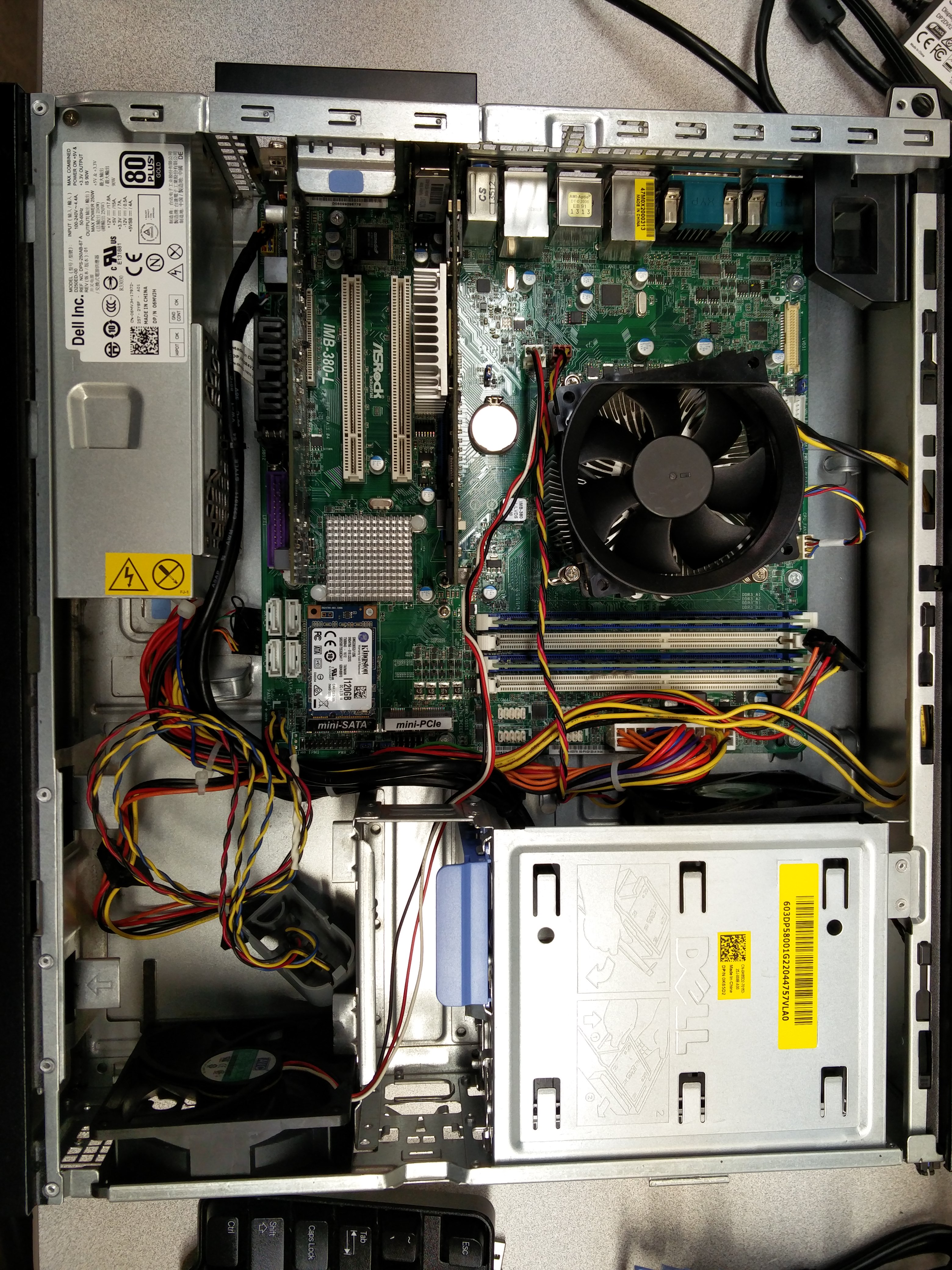

So, update: got the E3-1220L v3. it's quite happy in its new home:
I'm using a Dell Opteron 3010 case and PSU, which is just a nice form factor (and was my router until recently). Most of the actual components were in my main rig before I upgraded. The board is an AsRock IMB-380-L, which is a neat little board with dual nics. It's kept two sticks of ram for a total of 16GB.

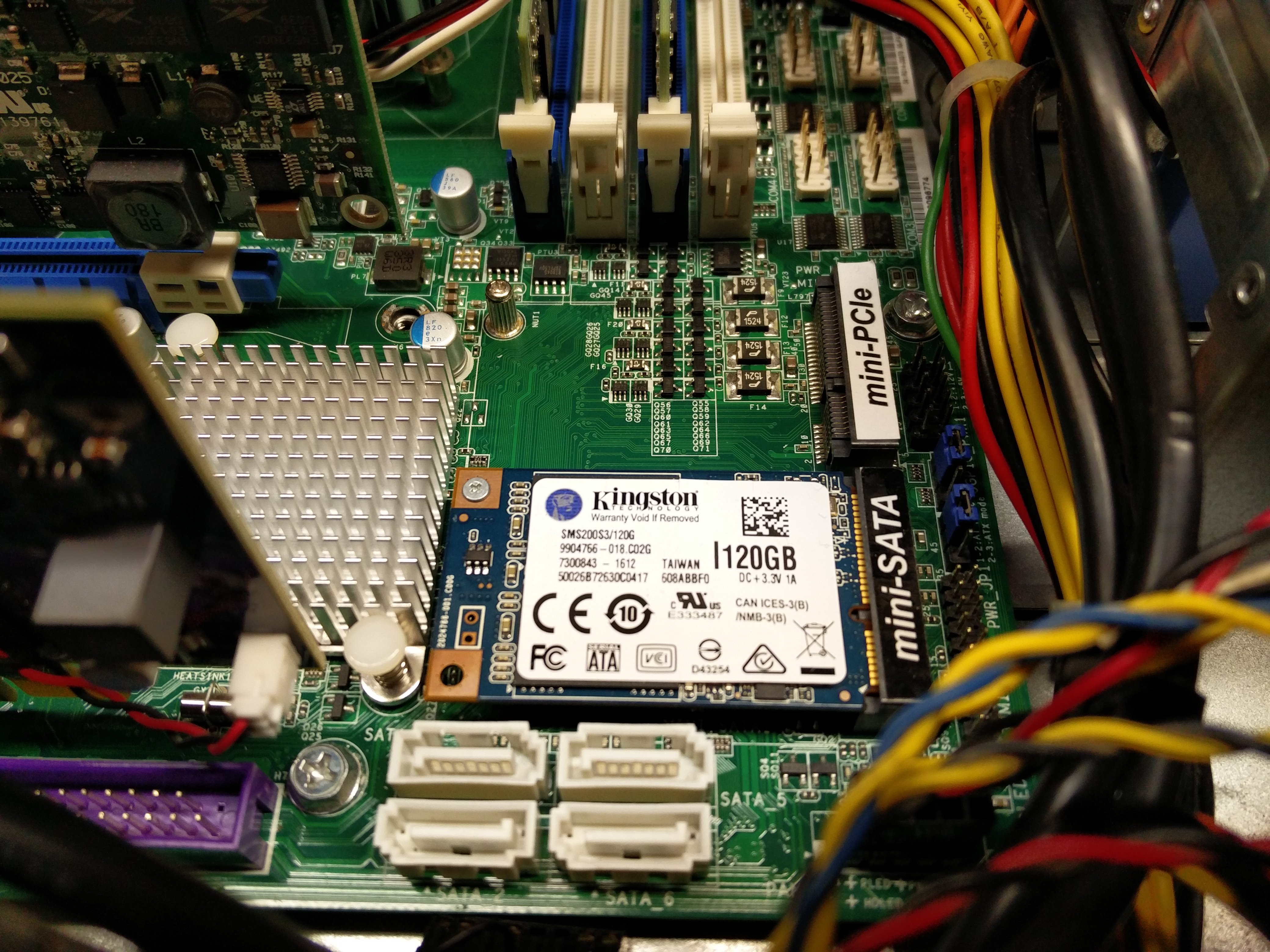

You might have noticed this thing down in the corner:
I don't have anything else with a mini-sata slot, so it could stay here. I plan to do caching on this machine, but I also already have a 500GB HDD set aside for this. It makes a nice boot device, but (being a router) I don't expect this to be booting all that often. I may even boot from a USB stick (there's an internal USB slot on the board, too).
Are there other pfSense applications/plugins that could make use of a nice, fast drive?

dunno as of right now. i have a few hardware things to work out, and I haven't decided if I'm going to install to disk or usb. I've turned it on and messed around a little bit, but nothing's really ready to go yet. I'll get numbers once it is. The CPU has a 13 watt TDP, so it ought to be pretty nice :smile:
I guess "power" would be another good argument for dropping the spinning rust in favor of the ssd.
