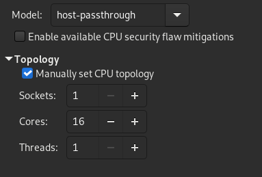

I noticed something off with the reported clock speeds inside the VM. Only Core 0 is hitting it’s normal speed 3.7. All other cores are reporting under 1ghz for the most part. I’ve attached 2 pics that were taken a couple seconds after minimizing the game. Also not all of the cores are showing in task manager or HWinfo.
The first is from Doom, you can see good utilization of the GPU and CPU.
The Second is from Metro, The CPU, and GPU are barely being used. This time Metro didn’t go above 10FPS.
If those reported clock speeds are correct that would most likely be either all or most of the issue. I have PBO enabled now but, I’m going to set a manual OC and see if that helps.
------------Edit 2-----------
I’ve been able to get the VM to display the correct number of cores/threads by setting the multiplier to 42(4.2ghz) did not help performance. The reported clock speeds of all cores other than 1 are still below 1ghz. I imagine this is just reporting incorrectly as I ran CineBench and it scores about 1/2 of the expected score. This makes sense since I’ve only passed through half the CPU. I’ve tested the Disk Speeds vis crystal disk mark, CPU via Cinebench(Both single and multi-core) and the GPU via games and they are all as expected when compared to Bare metal. I can’t find any bottleneck with the system and so far this is the only game I’ve found that shows this behavior.
