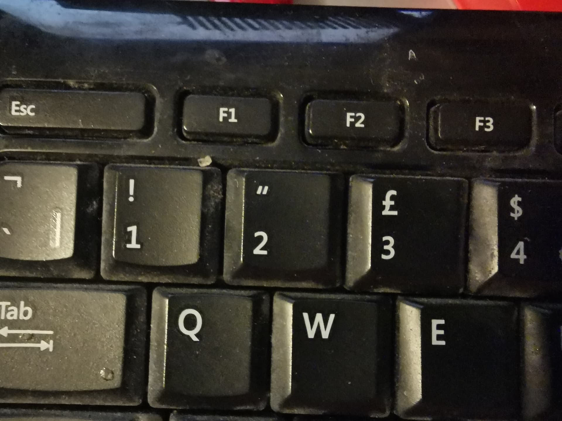

I can’t contain my happiness so here is an update. First of all I tried R@str 8 times with no success, then I thought I 'd try something. Keyboard layouts - sometimes the @ key is the " key. I have a UK layout.
And
Thank you guys
