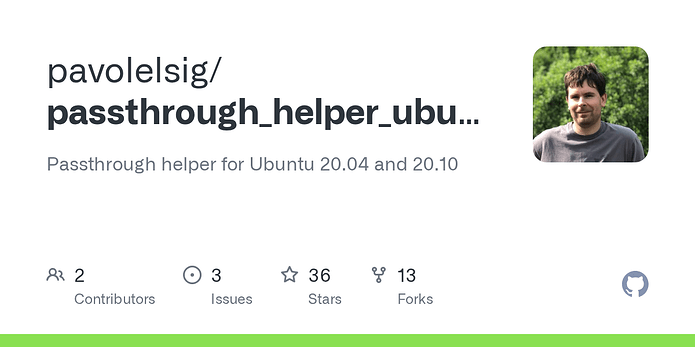

So i went here
and now I can’t connect to kvm with virt-manager
and sudo service libvirtd restart hangs
forgot a step
