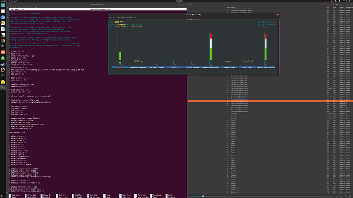

Made a few changes and I think I found and fixed one specific issue.
Edited pulseaudio - I’ll add a screenshot
Opened ALSAmixer in terminal and found that my headphones were set to <32Ohm and switched it to 64-300Ohm and its much better, as far as im concerned Headphones are sorted.

Now for the next order of business change you resampler in the pulse config to the highest quality provided by your system
Ok - so how do I determine the highest quality and then set it to that?
well since others have been deprecated… roll with speex level 9 or 10
So by that do you mean editing this line in pulseconfig
; resample-method = speex-float-1
to
; resample-method = speex-float-9
Yes .. sorry I got caught up bullshitting in the lounge. you got lost in the notifications hahah..
do speex-float-10

apologies if i misread this from earlier posts,
but appears to be something i have seen other people have a problem with
the semicolon “;” at start of the line acts like a comment tag
you need to delete the semicolon or the setting is ignored
I have known other people caught out by this
not surprising when most if not all settings are commented out
and another main Pulseaudio file in same folder (default.pa) only uses “#”
also suggest if you expect to do a lot of changes to Pulseaudio configuration:
  1. copy /etc/pulse/daemon.conf to ~/.config/pulse/daemon.conf
  2. leave original system file alone and only change settings in home folder copy
  3. reload Pulseaudio to load new settings
this made tuning settings easier and quicker
(or rolling back to system default easier if you mess up!)
and i can usually pull the home folder configuration into most new distros with no changes
