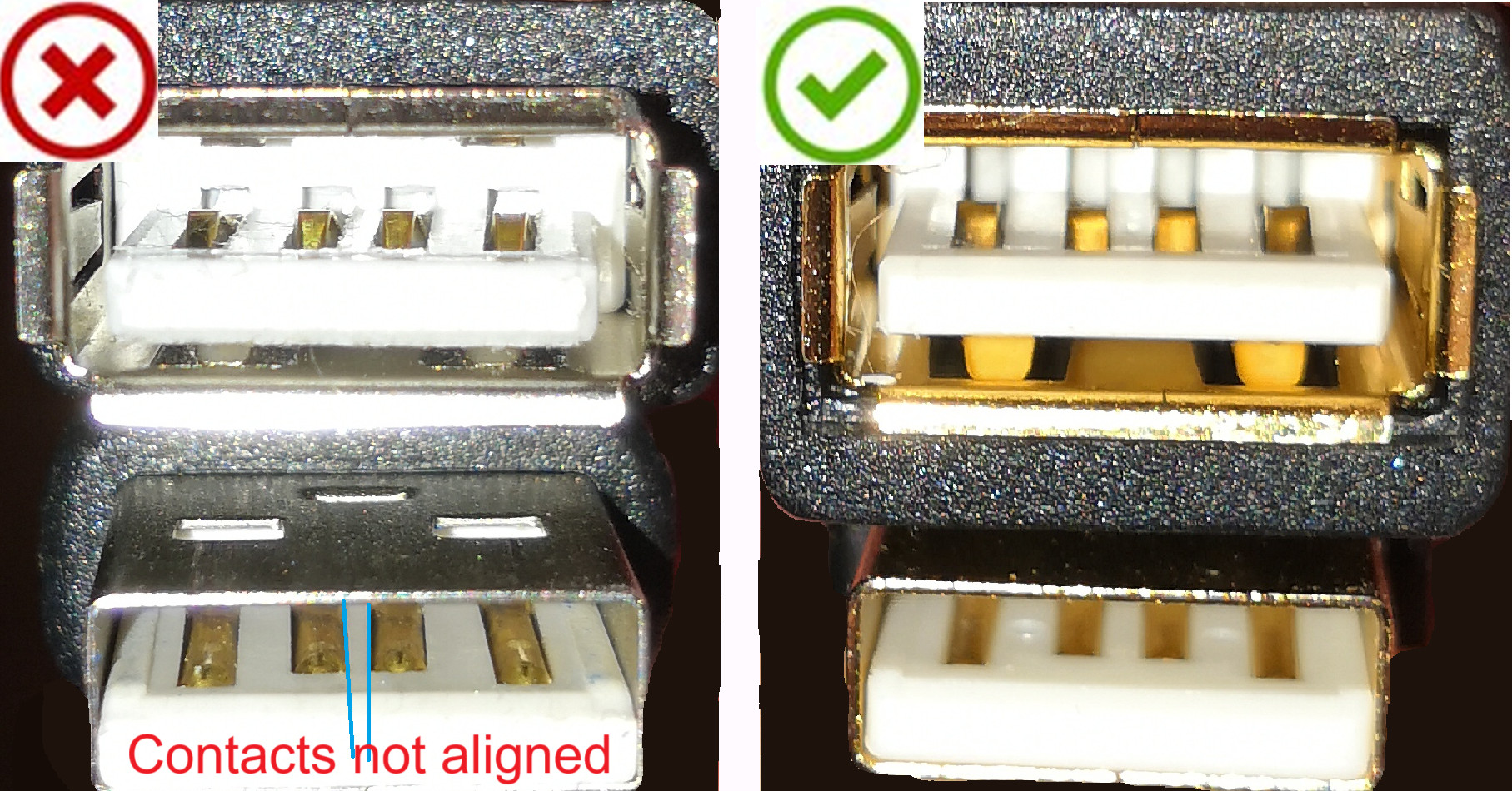

I tried various USB ports, and all give the same issue
I would try another USB cable.
