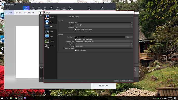

Having trouble getting OBS to play nice with my AMD gpu (Asus Strix R9 390).
I’m trying to use the GPU as the encoder, but when I select Encoder>Hardware AMD and try to record OBS freezes.
Just DDU’ed and updated drivers 86ing RELIVE. Same issue.

SOLVED
Uninstall Intel’s GPU drivers with DDU.
If a mod wants to close this one in a few days, totally fine with that. Just give me a few to test it more.
Did Windows Update auto install those drivers? If so, blame Windows Update. So now we know QSV and AMD don’t get along.
