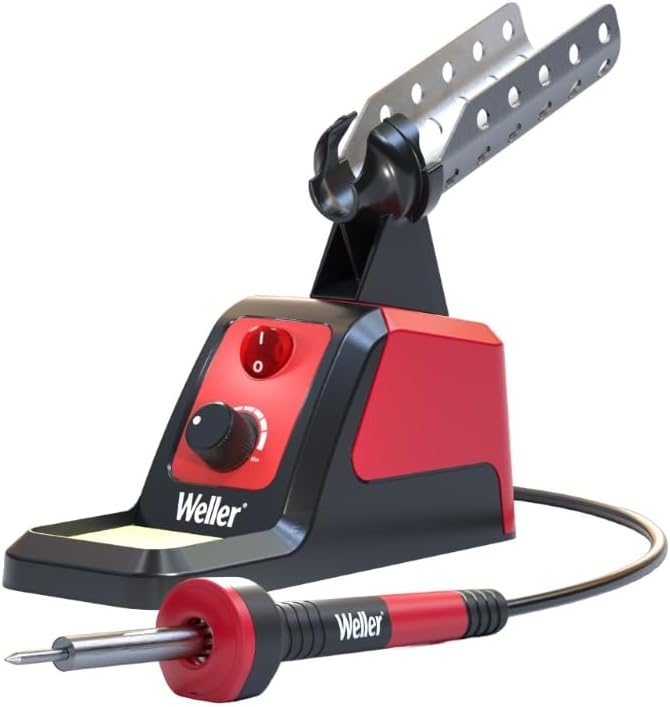

Needle nose pliers, side cutter, magnifying glass (somewhat optional), tweezers, soldering iron (get one of the better ones, Weller or Metcal for example), ...

Whatever iron you buy, get an adjustable - static (always on full power) ones are a waste of money even for beginners.

@CrossCarbon There's definitely good static irons out there, but then you're stuck with that one temp, esp if op want's to "get into" electronics he should get one that allows adjustments - some components might get damaged by too hot temps, and it's also alot easier to work with controlled melts instead of going all balls in instantly, also helps preventing cold joints esp with lead-free solders.

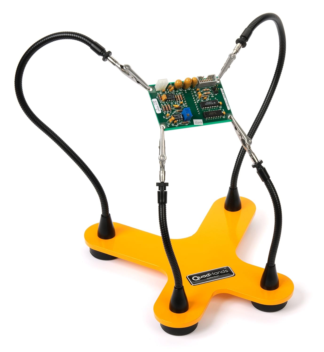

And as @Skelterz said squid arms or whatever you call them are defo better, just something that helps precision is a must.

A decent variable control soldering station is about 6-7 EUR nowadays, they make really decent ones in China. The most important feature is a flexible wire, because a stiff wire between soldering iron and station is awful. If you're in the EU, you have to use leadfree soldering material, and you will destroy stuff because the temperatures are always high. No need to go invest in expensive super precise variable temperature stations, because they're designed for anything but RoHS compliant soldering. Better get a decent cheap station with a bit of power, if you fry it, just get a new one for 7 EUR, it's cheaper than a replacement stylus for a premium brand station, and you can get decent French or German made styli for not too much money that fit on the cheap Chinese irons so that you get a premium soldering experience from a very cheap soldering station. In the EU, because of RoHS, you just have to factor in the extra cost of destruction of parts, so spending less on a soldering station is usually a safe idea budget wise. The extra cost of destruction because of RoHS is really high. In fact, I use new old stock lead solder for prototyping because RoHS compliant solder is just too bloody expensive, it really make a lot of difference. Of course you can't sell anything if it's not RoHS compliant, so you can only use leaded solder for prototyping.
First tip is to not buy a garbage soldering iron. Don't feel like you need to spend $100+ on an iron if you're just starting out, but I also wouldn't start out with a $5 one. This is what I'm currently using and I am quite happy with it. It's not the best thing out there but it's cheap. If the tip goes bad then new ones are about $5-10.

  • Helping Hands, an Octopus holder thing, or a Panavise will make soldering so much easier.
  • Adjustable soldering irons are nice if you are working with different types of solder and/or different materials being soldered. Stations with a stand and space for a sponge or other tip cleaner also makes life easy (and safer).
