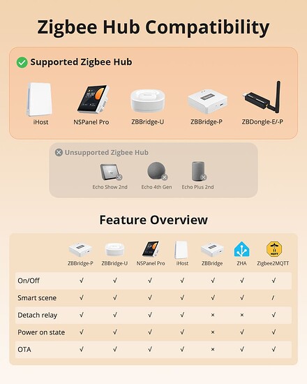

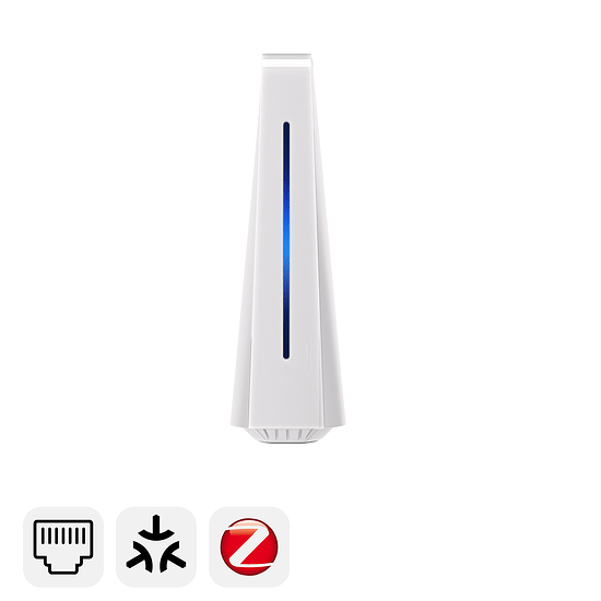

There are a multitude of solutions, including HA. But there are also brand-specific solutions. Sonoff has iHost and NSPanel, which can act as a local control point without the need for a cloud.
Some Sonoff products have a mode called LAN mode, which allows for very limited control without the internet or a central point, simply via the LAN app.
In an extremely simplified model, if you opted for ZigBee, the Sonoff ZigBee Bridge Pro could theoretically control devices locally without the need for a cloud or other solutions. But this is a very limited scene model.

A possible alternative to the HA machine in the case of Sonoff products is the iHost. This is their supposed HA in a simplified form for their devices.
Apparently you can also run HA on it as docker…

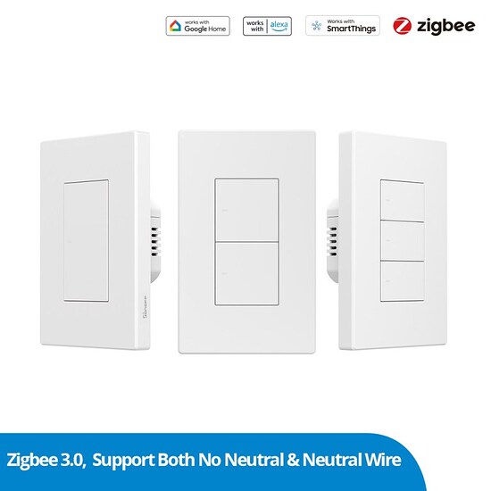

Regarding the physical ability to turn on/off when the controller is unavailable, almost every switch should offer this capability.
However, if you don’t plan on centrally implementing HA/something and the cloud is sufficient, and in the event of unavailability, a physical on/off switch will suffice, then… many brands will be suitable, including Sonoff.
