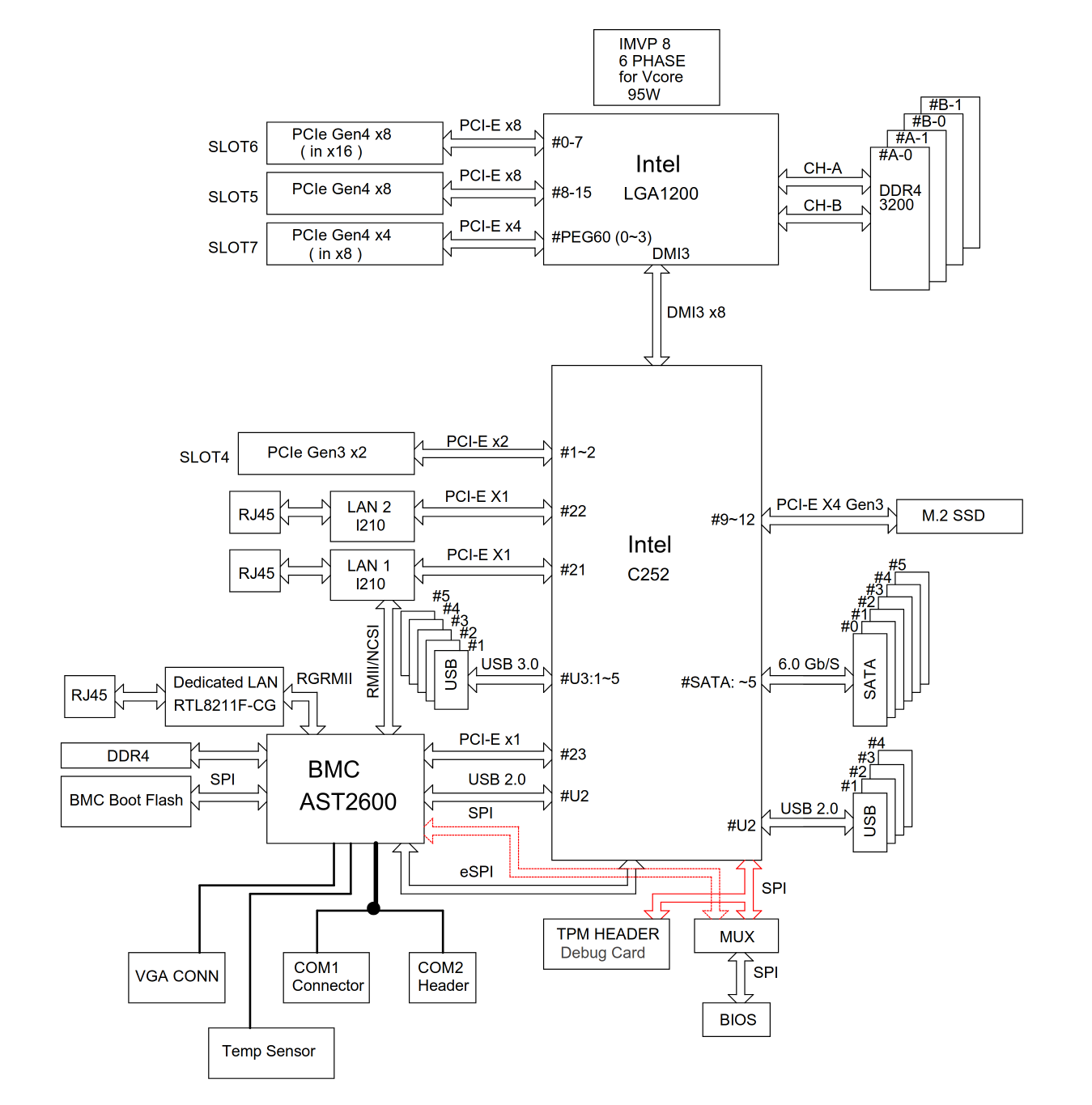

The chipset connected PCIe lanes on my Xeon E 2314 (Rocket Lake) on my SuperMicro X12STL-F motherboard (C252 chipset) are absolutely horrible bordering on unusable.
Now granted, these are 8 lanes of DMI Gen3, vs I think 8 lanes of DMI Gen4 on the x790, so the Z790 should probably be slightly better, but still just be aware that chipset lanes can be rather unimpressive performance wise.
I don’t know why Intel’s DMI setup has worked worse for me than AMD"s PCIe setup. ON paper DMI has quite a decent amount of bandwidth, and on my SuperMicro X12STL-F I am using very little of it (only on board device I am using is a single Gigabit ethernet port) but the difference has been quite huge in my application. I originally tried running a mirrored pair of Optane drives on this board, one on th eprimary M.2 port that connects to the chipset, and one on a secondary slot that connects through the CPU, and performance was absolutely awful until I switched them both to proper CPU lanes using risers.
Here is the diagram for this board:
So when one of the Optanes was in the M.2 slot off the chipset, and one was in SLOT7 connected to the CPU, the performance was awful. These weren’t even high end Optanes. We are talking 2x Gen3 each. In this configuration I got like a quarter of the expected performance.
But when I moved the Optane drive from the chipset m.2 slot to a second riser in SLOT5, they operated as expected at full speed.
IN this test, almost nothing else on the chipset was loaded up except maybe the BMC.
So just keep in mind that using chipset slots can be unpredictable, and can cause lower performance than expected, especially on Intel implementations over DMI.
