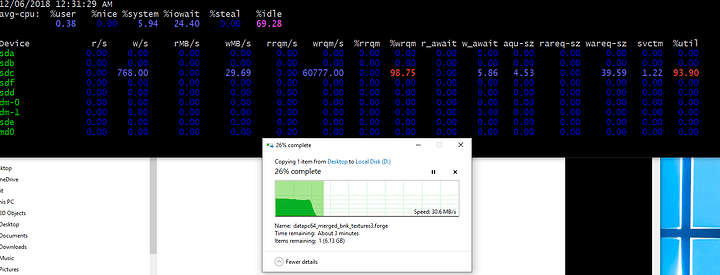

@nx2l, i have now weird things happening, i was planning using LVM +cache for iSCSI target but i cant get speed up ( backing-store /dev/vg/lv example) using disks directly has same problem, max speed that i have gotten is between ram disks ( 300 MB/s write from client to server and 500MB/s read ) but with HDD 20-40MB/s ssd max out at 200MB, problme is usally writing from client to server, reading is a okey. Mounting devices localy in server i can get devices max speeds R/W ( dd if=/dev/zero of=image.bin bs=1M count=32767 status=progress ). This is crazy, server specs are AMD FX-8300 RAM 20GB client AMD Ryzen 7 1700 8c/16t 16GB NVMe main drive. Network 2xMellanox ConnectX-2 over Fiber, MTU=9000. Nothing works :skull: I am asking for help if somebody recognises symptoms.
try collecting data when you do your testing.
with iostat , vmstat, top , etc
This is test with drive as backing storage for iSCSI and speed are 20MB/s
<target iqn.2018-12.virtual-n1:mainpc>
 <direct-store /dev/sdc1>
  write-cache off
 </direct-store>
</target>
probably somesort of config problem ( meatbag between chair and keyboard )

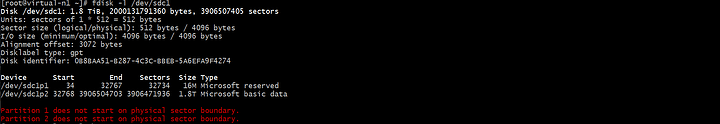

and this is test same drive formated ext4 pri par using fdisk
direct-write-iostat-dd-speed
10x speed diff :slight_smile:
I’d bet that warning about unaligned partitions is mostly to blame
No part erro results
something is causing that high wait %
Try to track that down.
