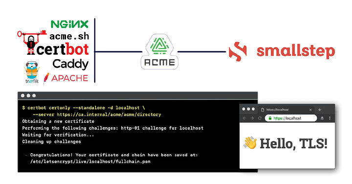

For local infrastructure, use certbot + nginx (local TLS termination + vhost reverse proxy) in combination with step-ca:
Setup e.g. the whole .internal domain in your DNS server to point to the VM/container/machine hosting the nginx server.

The smallstep.com guide appears to require exactly that; installing my own custom cert authority onto all devices.

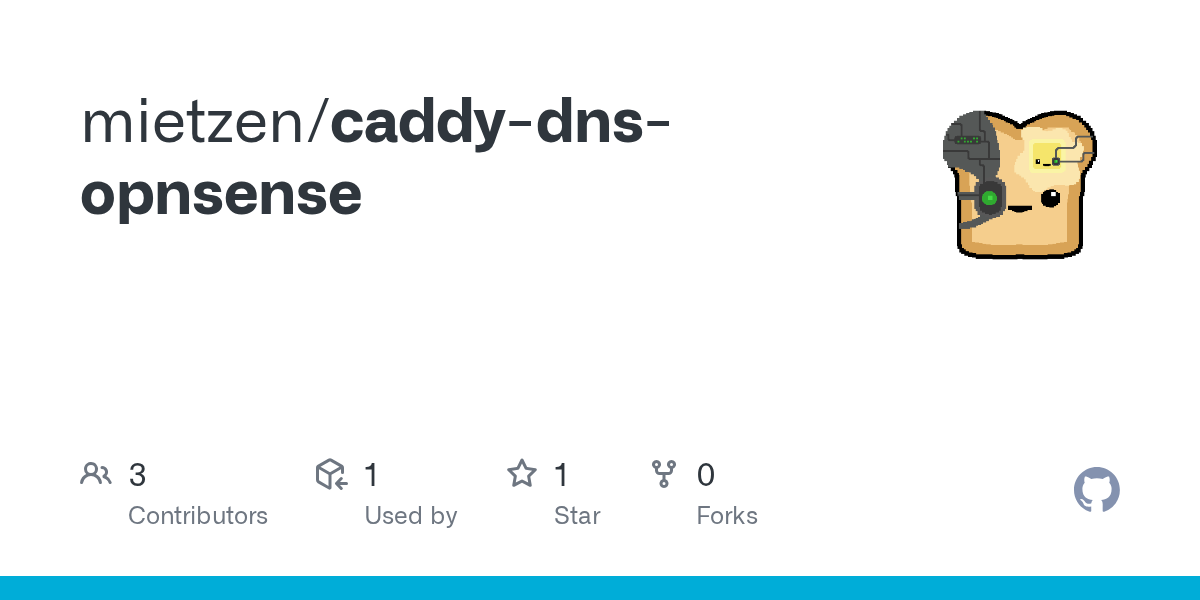

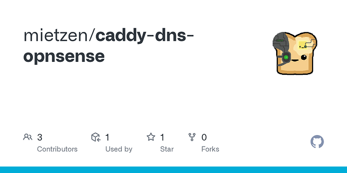

I created a module for caddy and opnsense to do exactly this:
It automatically adds dns host / host overrides to dnsmasq / unbound if you add a new entry to your caddy file. TLS certs are loaded via DNS-01 challenge. So you don’t expose anything.
I also forked caddy ddns and added a feature to cleanup unused entries, you can use this with the docker module for dynamic service discovery / deletion.
If I find some time I might do a write up of all this.
PFsense has a similar API, the code would be easy to port.

With your Caddy-DNS-OpenSense project, will it work with essentially all web services which require SSL/TLS encryption?

All that support to be run behind a reverse proxy. I never seen anything that couldn’t be configured to run behind a reverse proxy, so I would guess:
Yes, sometimes with some configuration, e.g. stetting something like allow-origin or trusted-proxy etc.

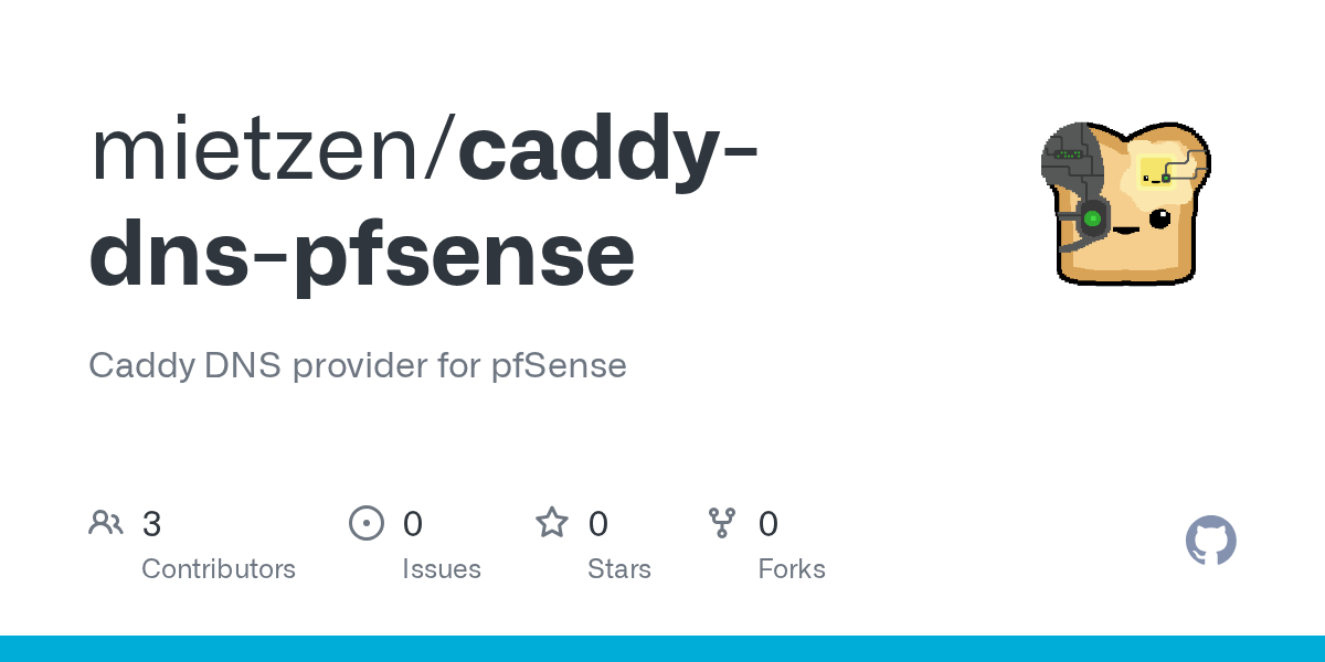

Edit: @TheAlmightyBaconLord Did a quick and dirty port based on the open-api.spec :smiley:
This is untested!
Build with:
xcaddy build \
    --with github.com/mietzen/caddy-dns-pfsense \
    --with github.com/mholt/caddy-dynamicdns \
    --with <YOUR-DOMAIN-REGISTAR> # https://github.com/caddy-dns
Caddyfile:
	acme_dns <YOUR-DOMAIN-REGISTAR> {
		api_key {env.DOMAIN_REGISTAR_API_KEY}
	email {$ACME_EMAIL}
	dynamic_dns {
		provider pfsense {
			host {env.PFSENSE_HOSTNAME}
			api_key {env.PFSENSE_API_KEY}
			insecure true
		domains {
			{$BASE_DOMAIN}
		dynamic_domains
		ip_source static {$CADDY_SERVER_IP}
		check_interval 30m
		ttl 1h
		versions ipv4
.env:
BASE_DOMAIN= # example.org
CADDY_SERVER_IP= # 192.168.1.10
ACME_EMAIL= # [email protected]
PFSENSE_API_KEY= # SOMEAPIKEY
PFSENSE_HOSTNAME= # 192.168.1.1 or pfsense.internal
DOMAIN_REGISTAR_API_KEY= # SOMEOTHERAPIKEY
