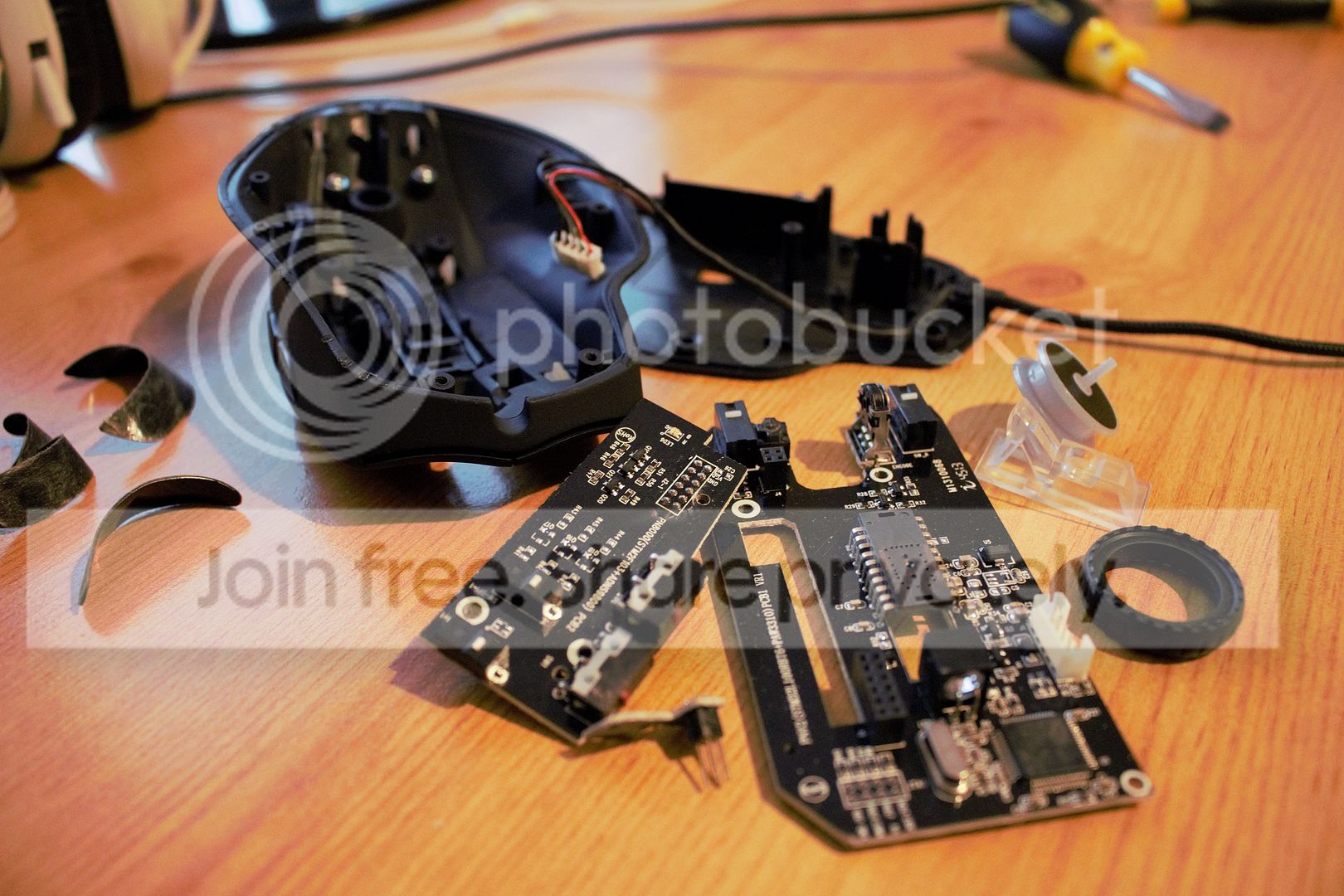

I have a Mionix Naos 7000 mouse, with a defective mouse wheel. It is really stiff at one point in the cycle. The issue seems to come and go, ever since I got it. It is now out of warranty.
I figured that I would try servicing the mouse wheel. As it may just be something jammed in the wheel. However I have found little documentation on how to do so, bar these photos (below).
I have tried pulling it apart, to no avail. I would need something very thin to pry it open; if that is even how it is disassembled. I don't want to break it.
I paid a lot of money for this mouse, and really like it. If I were to buy another mouse, I would get the same one. I don't want to have to do that.
Has anyone here had much experience with tearing-down mice? Any help would be greatly appreciated.

Try blowing compressed air through it and dabbing Isopropyl alcohol along the wheel in small quantities while spinning it.
Depending on how the top and bottom assemblies were adhered, opening it may permanently damage the unit, but it's possible that using a Shiv or razor blade you could open it.
I've used a razor blade to cut hard plastic open along solid joints then closed it back up with Super Glue or epoxy, but that's not for the faint of heart.

@blaxa Thank you for the advice. I think it does open up, as shown in the pictures. I just don't want to snap anything in the process.

Okay I thought I would finish this thread off for closure and future reference.
After unsuccessfully trying to break open the mouse, I located four screws underneath the feet-pads. Unscrewing these screws allows the mouse to come apart. I ended up completely taking the mouse apart, for fun. The only issue I could find with the mouse wheel was that the rubber ring-grip wasn't a tight fit around the wheel itself, which resulted in a little bit being raised. In turn this was rubbing against the outer-shell of the mouse, as there is not much space separating them. Filing down the outer-shell around the mouse wheel fixed the problem.

I'll be honest with you, Blaxa. When trying to pry it open, I really messed up around the edges. Although I sanded them down, the damage is still noticeable.

If you do decide to take it apart, I would recommend warming up the feet before pealing them off (screws are located under). As removing them at room temperature will probably damage them. They become warped, and won’t go back on properly. Replacements are around £8.
Actually found a youtube video of a guy who seems to have done videos of disassembling many different mice, and it looks as though he just uses lighter fluid. Even had a video of the castor, no Naos video though. That said, of course that will make the glue rather useless…not that it would work great after anyways. But it makes sense, I use it all the time to clean my knife, which more often is gunked up with adhesive from tape, and it works great.
