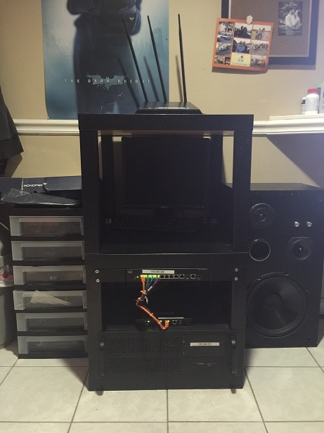

I built an ikea lack rack (google it) so I needed short depth cases...as the rack is only 19" long (its a square table). This is the, by far, cheapest way of rack-mounting your stuff.

If going the Lack route, or building your own shell, you can buy just Middle Atlantic Rails and screws on amazon for fairly cheap. At least secure them properly vs screwing you components directly into particle board. As for cases, I went with the silverstone gd08 for my media server case as it is rack mountable.
Keep in mind rackmount cases aren't designed to be mounted by the ears. They are designed to be mounted on rails on the side.
If you are going to build a LackRack either start stacking that the bottom or have some kind of support for the backs of cases.
Rast is the solid wood version of Lack. It holds screws better.
I would use L-shaped brackets below the heavy components. As those that I possess are dell with the dell rackrails, which do not have any screw holes at all as they clip into the 19" rack rail system

If you actually want to screw all your stuff in with ears, and somehow hang it---then a RAST is your better option.
But since its ALOT cheaper to buy 2 or 3 $4 tables and a couple of L-brackets... I went that route. But you must know-- the legs are hollow in the middle...with only 2 or 3 inches of particle board supporting them on top and on the bottom.
The only thing that's mounted with the rack ears is my switch...which is at the top... and because its short and relatively light. everything else is just stacked from the bottom.
Keep in mind. Mine is 3 tables.
Heres a couple pictures of my rack, one is old and has my Cisco switch, but you get the idea.
Uhh thank you Sir for mentioning that! Maybe drywall anchors could help solve that hollowness issue
Very nice rack by the way
