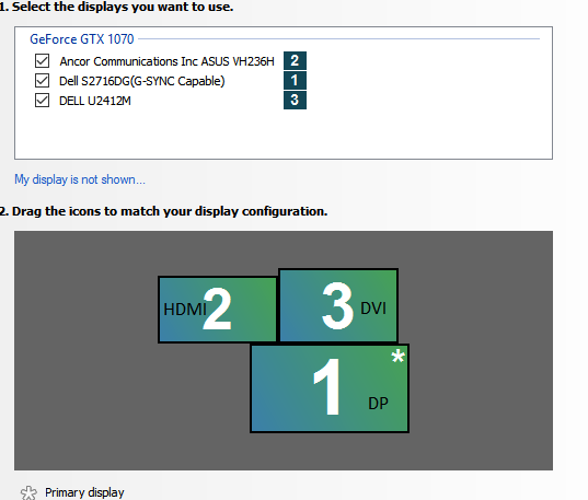

Here is what my setup looks like:
This is along with a Gigabyte GTX 1070 G1 stock settings.
Primary monitor: Dell S2716DG 2560x1440 TN 144hz G-sync
Secondary: Dell 1920x1200 IPS 60hz
Tertiary: ASUS 1920x1080 60hz TN
When I have the S2716 set to 60 hz there is no problem. But when I set the hz to 144 I immediately get a noticable lag on the second and third monitor, maybe around 100-200ms. I'm clueless why this would be the case. Any suggestions or theories would greatly appreciated.

Try swapping the outputs around. Different arrangements might help.
I actually gave that a shot a few days ago, no change.
