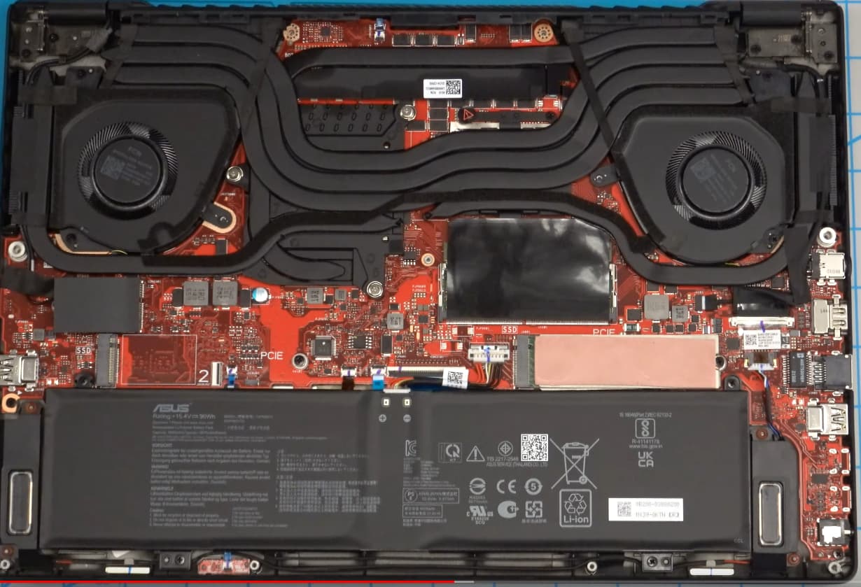

The hardware
Asus ROG Zephyrus M16 (2022)
12th Gen IntelĀ® Coreā„¢ i9-12900H
48GB RAM
4TB Kingston Fury m.2 Gen4 SSD - Should be fast, was dissapointed
Internals
It is possible to fit two m.2 drives in the machine with one running at PCIe 4.0 and one 3.0
Running Windows 11 with Bitlocker enabled
