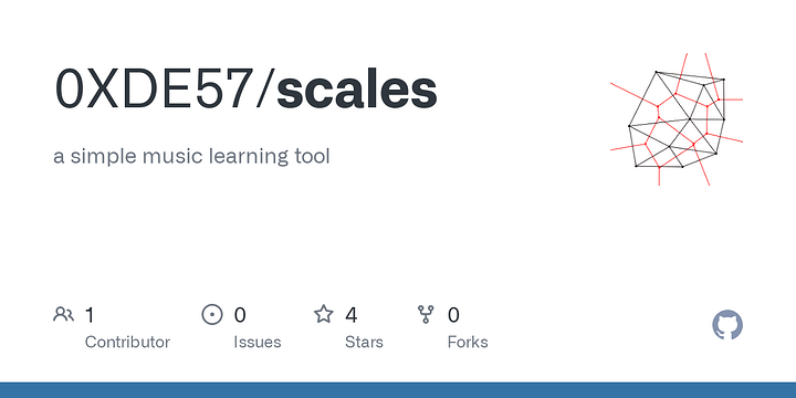

Hello! In an effort to learn both python and a bit of music theory, I started making thing little music toy thing in a while ago in python. Like a lot of my projects I tend to start them and get distracted. But felt like coming back to this one for a bit.
The idea is this; I wanted to tool to help me learn scales and highlight notes on a keyboard and guitar so I can easily map between them.
You can select a root note, and a scale. And it highlights those notes on a virtual fret board and a virtual keyboard.
The color coding for octaves here to make mapping notes between guitar and keyboard easier. And you can find the same chord in multiple places along the guitar.
There’s a lot of other things I want to try with it.
