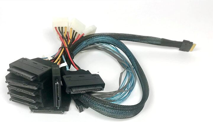

perhaps this cable might be a better solution as it is the 8i application + molex power. SlimSAS 8i (SFF-8654) Straight to 8X SATA Cable - 1 Meter
looks good, and the SFF-8482 looking end, looks to be able to connect to both SAS and SATA, with goldfingers in the bridge for a possible second sas lane, if supported
