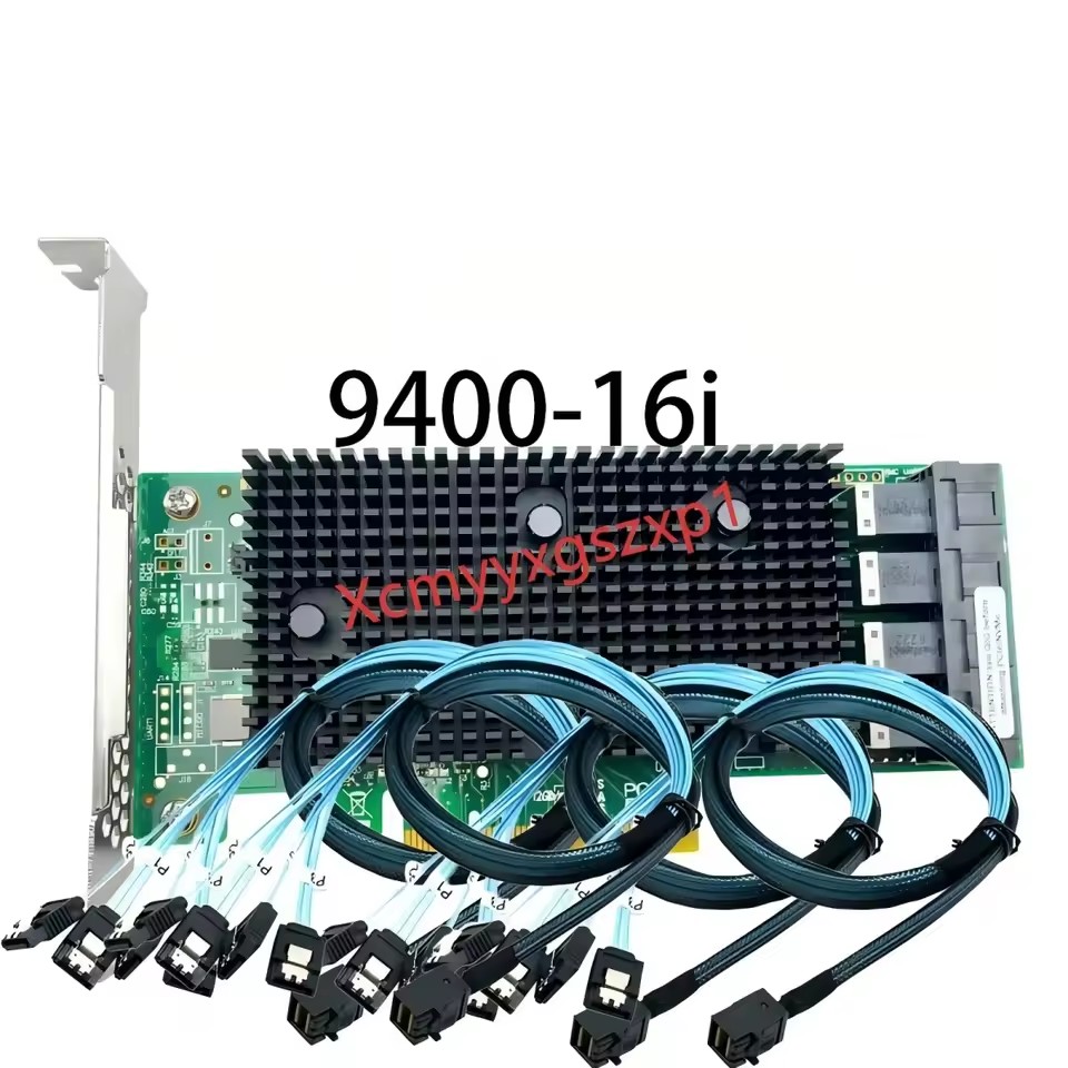

I already have this card (it hink? the board looks really similar and I think this is the same controller model) I got from aliexpress, which is working fine so far, it’s getting really hot but I just ziptied a fan to it:
LSI 9400-16i SATA/SAS HBA
https://pl.aliexpress.com/item/1005012360215393.html
And I still have one PCI-E 3.0 x16 slot I could put stuff into, I was thinking about buying the same controller again but maybe there is a way to get more out of that x16 slot I have, ideally I’d like to have twice as many SAS ports on it.

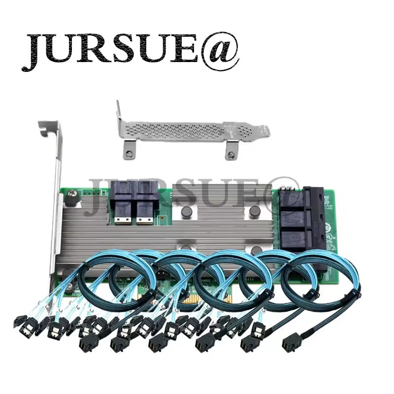

I already tried looking on ali and the best I found is this:
LSI Logic Mode IT 9305-24i 24 port
https://pl.aliexpress.com/item/1005010536121175.html
The problem is that I would pay more than twice as much for only 2 more SAS ports, pretty bad deal imo as I’m not that desperate to fit more disks into that NAS.
