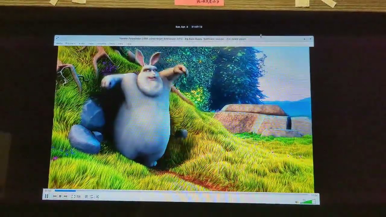

VLC seems to be very good at triggering it, I’ve seen others do it as well, sometimes it’s the entire screen, sometimes just a section of it.
WARNING: FLASHING!
