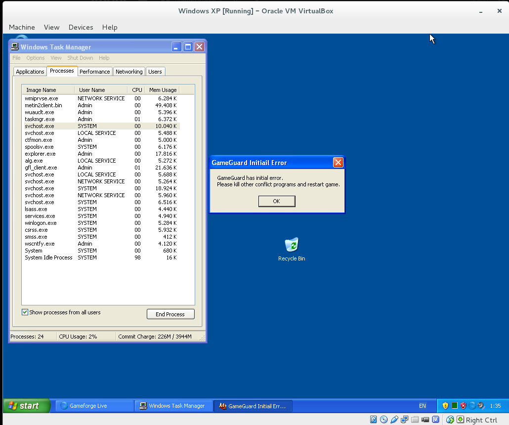

Tried installing windows xp sp3 and the same problem is appearing.
I think it is time to give up, I can’t identify any processes that are conflicting.
These are the processes running on the VM,
Imgur
It seems the “We don’t care about VM users, they’re using VMs only as an excuse to BOT” mentality affects this game as well, as I couldn’t find a single working solution. I don’t think I can help you, but you can try some of these bizarre ideas:
