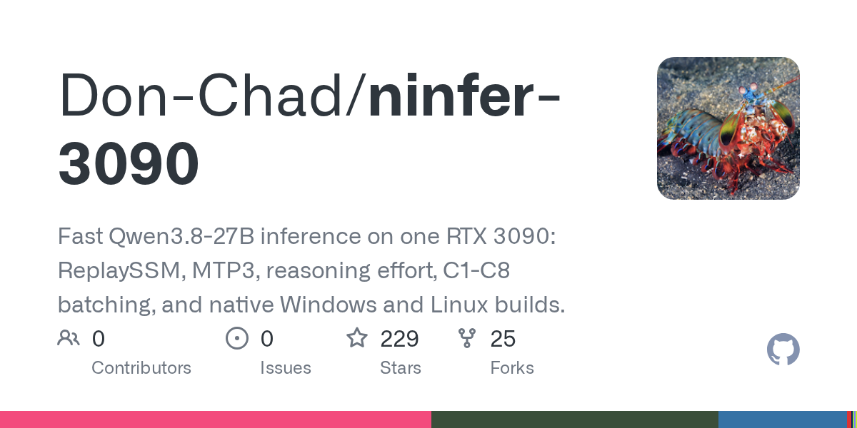

However you are on Linux and you do have a 3090 already. I think the best experience here is to use the ninfer for for the 3090. ninfer is a small inference engine, like llama.cpp or ollama but specifically made for Nvidia Blackwell and then Qwen models. Someone did a fork of that and optimized it for the 3090.
This should give you by far the best speed you can achive on a 3090.

I use it on my Blackwell card, so I have no experience with the fork for the 3090. But trying it is definitely worth a shot.
I got ninfer to run and it’s roughly double the tokens per second. (From 35-40 up to 55-60)

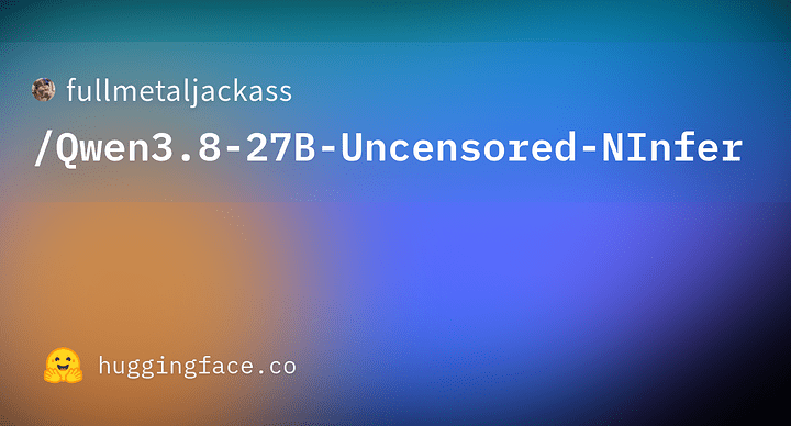

You might look on Huggingface, I found the following which could be in the direction you were looking for …
I had a look earlier but didn’t find that. Thanks. I’m not sure if that’s for the 5090 version though. It looks like it’s ‘easy’ to port a model into ninfer but then I’ll have to also configure it for the 3090 version. I’ve never done this before. If I get a custom thing working i’ll report back.
Got qwen 3.6 27B Ninfer abliterated off of somewhere. runs really well. I would like 3.8 but got no idea how I would convert a model to ninfer
