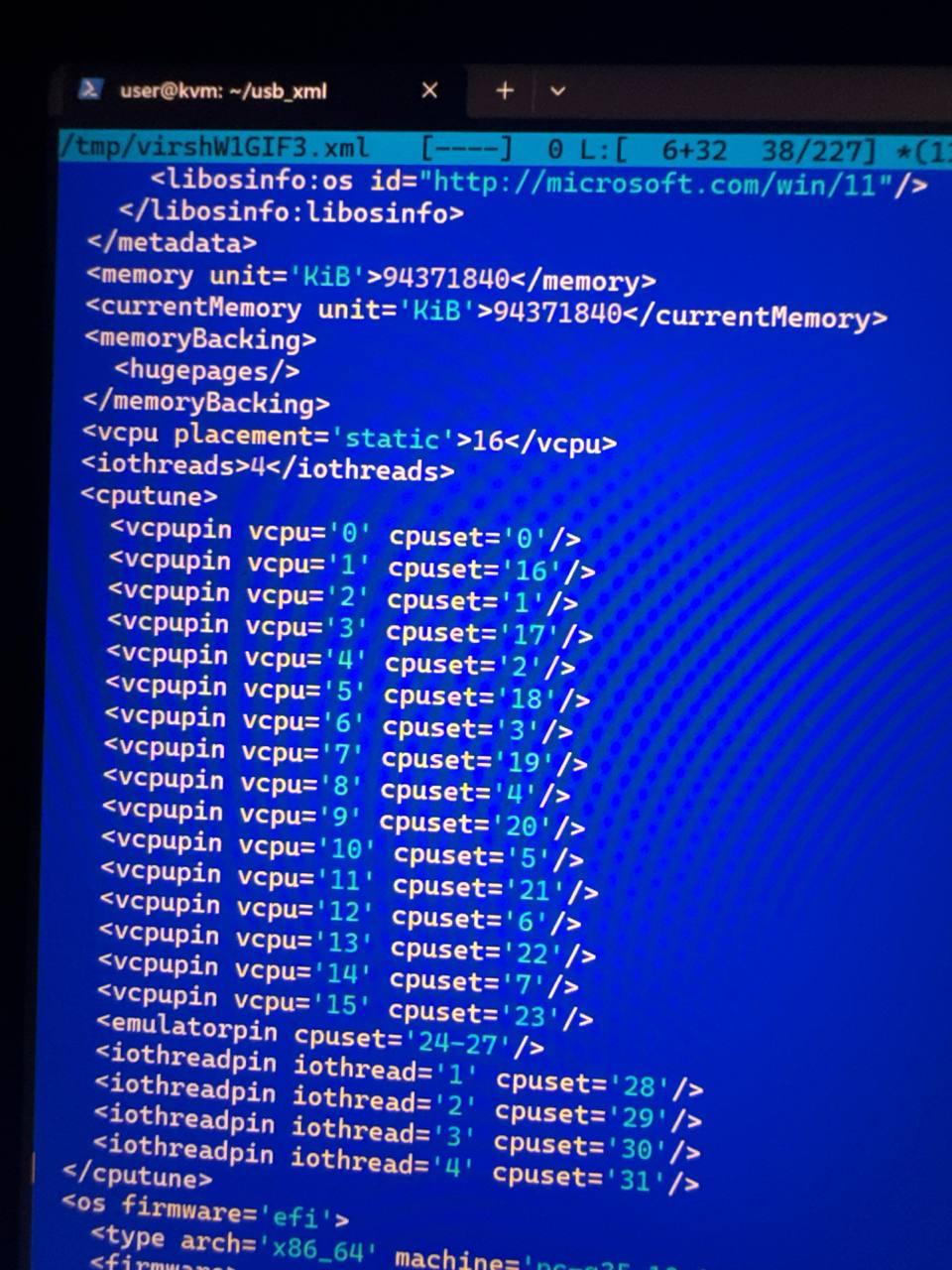

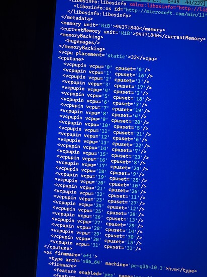

That’s weird. I have VBS and nested virtualization enabled and didn’t see any problems with that. O_o
