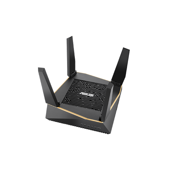

Hello I am in the market for a new router as I am moving to a new place and do not want to rent one from ISP. I would like for it to be fairly easy to set up with verizon fios. I also would like to have newer features like gigabit LAN ports, wifi6, etc so it can last longer into the future without it needing to be replaced. I also would like for it to be easy to set up/connect a mesh network in the future if I decide to add some WAP or anything. It seems like ASUS has had this thought in mind for a long period of time and made their devices easy to set up for mesh networks. My budget is around $200USD. Would like for it to be as cheap as possible, but willing to spend the whole budget if it is worth it. I want good strong wireless signal with fast speeds. My internet speed will be 200d/200up, but want to prepare for gigabit speeds just in case I decide to upgrade my speeds. My current place will be small, but would like for this router to be good for a single family home. I am currently looking for a single device that would be a good start to a mesh network if needed. Any advise/suggestions is greatly appreciated. Here are the two I am considering getting:
I’ve been using ASUS routers for awhile now, currently using this model router: RT-AC87U

Is the asus I linked a good start?
They all are pretty similar, you can always send it back if you don’t like it.
