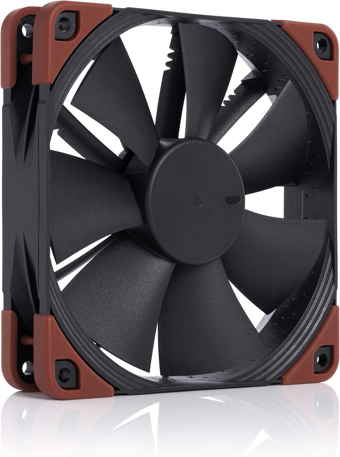

I've used these Noctua, they are very powerful but they are super loud needless to say I was very disappointed even the 2000 RPM model with a speed reducer is loud. Go with some yate loons they sell a 2200ish RPM model for like 6$ USD they will do the job for what you are looking for without being overly loud. Conversely as you have a restricted intake and are looking for pressure consider Sliverstone fans

Bottom line poo brown = bad value for money
