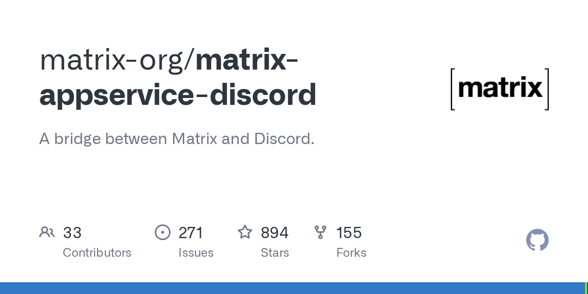

That’s a shame, because it makes much more sense than Discord. Hopefully we can popularize it in light of the 1.0 release. I went ahead and joined it! Maybe we could host our own so we can use the Discord bridge.
