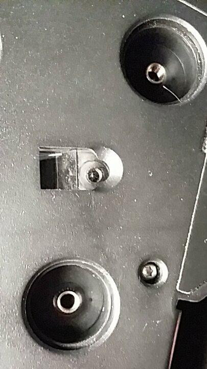

Thanks for the input, I was trying to take it apart but I am not sure about something. What type of screws are these and how do I removed them?
cant really tell. can you provide a higher res image?
I dont have a camera that good but I can tell you it looks like a hexagon in the middle.
thats a poor picture but looks like a torx from here, from a guess.
not a torx

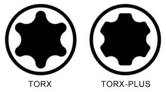

I think they are Torx according to a guide I found.
For a similar mouse.
its not the greatest pic… but you would know better. a torx will almost look like a alan key… except it has points on it… Perhaps a 6 pointed phillips screwdriver is another way to explain a torx
here is a pic… also if you got a chevy vehicle the signal lights are usually held on with torx.
11555-9635682
Thanks for the input, I am gonna go look for a torx screwdriver.
Might as well get a tool set. I just have a cheap shit one but one from iFixit would be a good investment.
Looks like standard torx FWIW. There are two types:
