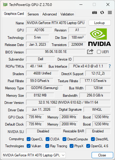

However, when the eGPU boots up, I have no access to Resizable BAR with the RTX 5070, and the RTX 4070 reports “Cannot read PCI Config Space” through GPU-Z, which seems to be a library reporting error.

So somewhat of a success here - if I go full DDU and reinstall the drivers without rebooting, I get both the RTX 4070 Laptop and RTX 5070 to work WITH Resizable BAR (ReBAR, going to use that moving forward) - Removing the Device ID from the screenshots just in case (I have no idea and I’m tired :slight_smile: )

I’ve managed to get ReBAR working at least on ONE video card, the 4070. If I run this script (vibe coded for now) I manage to get the dGPU to recognize ReBAR at the end of it. I’m testing this in a very haphazard manner, and very unscientifically. I wish I could understand at length the details on how my laptop brings up the whole stack of PCIe devices online, but I think I’m smart enough to not let an AI gaslight me into believing something.
