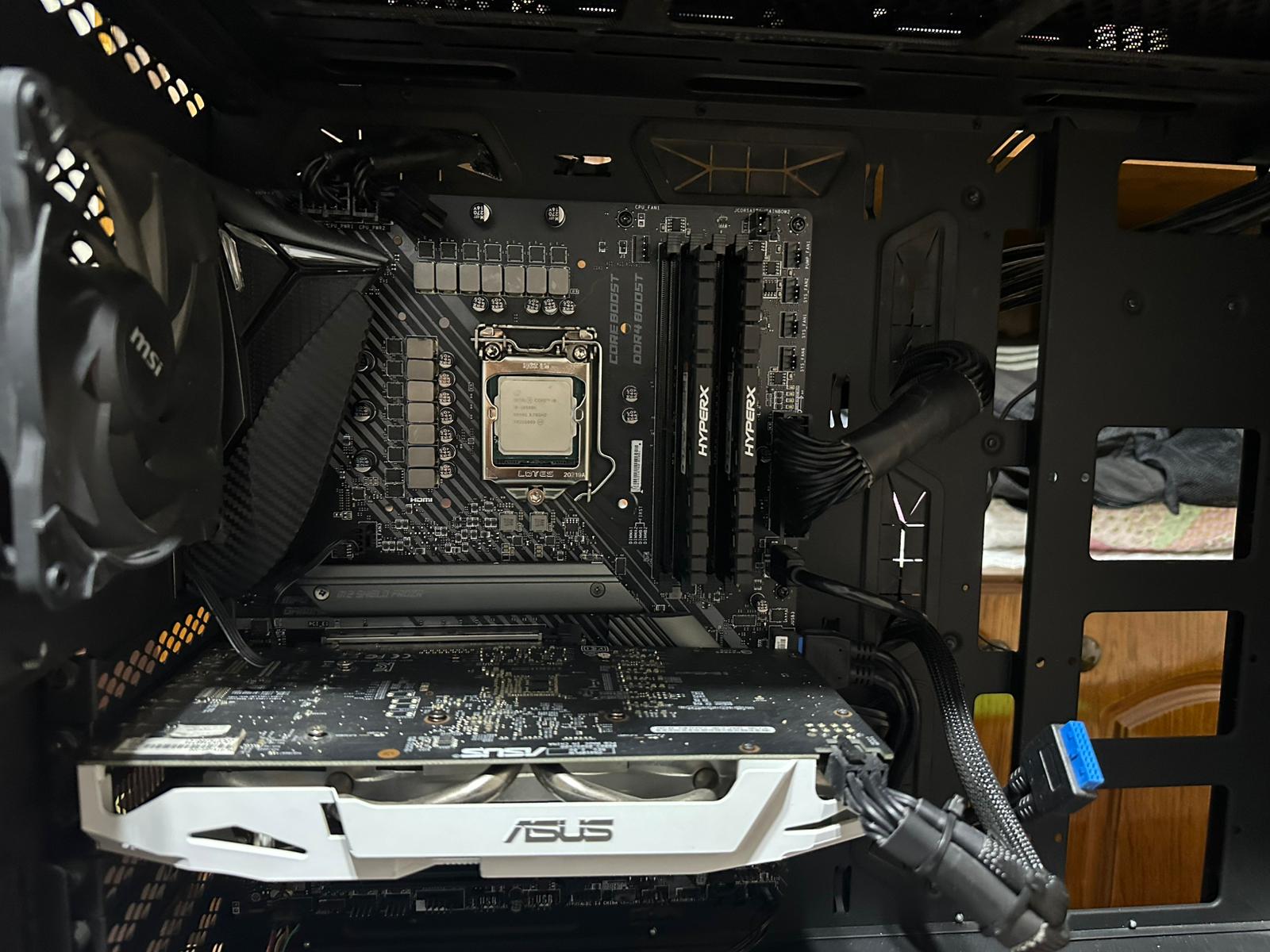

My Corsair H150 RGB 360mm AIO has failed after 3 years, exhaust air stays at ambient during load, pump reads 3000+ RPM but heat never reaches the radiator. Done with liquid cooling. Looking for an air cooler replacement.
**System:**​
  • CPU: i9-10900K (LGA1200), power limits set to PL1 200W / PL2 250W​
  • Motherboard: MSI MPG Z490 Carbon EK X (large VRM heatsinks)​
  • Case: MSI MPG Sekira 500G, 170mm CPU cooler height limit​
  • RAM: HyperX Fury RGB DDR4, 2×16GB, ~41mm tall​
**Measured clearances:**​
  • VRM heatsink to leftmost RAM slot: 120mm​
  • VRM heatsink + RAM combined footprint: ~40mm​
  • Max cooler height: 170mm firm limit​
Cooling performance matters, this CPU pulls 200W+ sustained under load.
Has anyone run a dual tower air cooler on a Z490 board with high-profile RAM? Any fitment issues with the VRM heatsink or RAM clearance?
Open to suggestions.​

Buy a cheap thermal gun, heat the RAM modules until you can remove the heatsink without tearing the ICs along with it; it sounds scary, but it’s just patience. That heatsink is only a heatsink in name anyway, you’ll find the modules cool off faster without it :slight_smile:
Clean up the goo with isopropylene. Gently.
Buy a Noctua NH-D15 G2. Remove that exhaust fan; Noctua’s dual fans will not only double as an exhaust, but will actually perform better without said exhaust fan so near them. Aerodynamics, not opinion.
There are other coolers, yes, minimal differences, but worse fans, will get louder and louder in the long run; to this day, Noctua remains the choice of choices.
