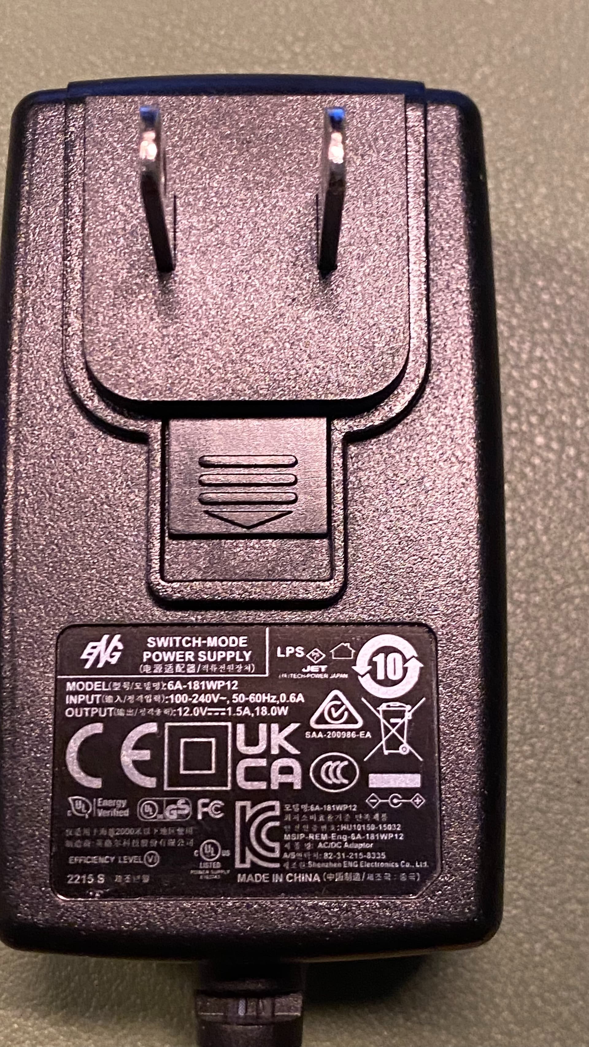

In the UK here, I’ve got one of your KVM switches second-hand being delivered, but unfortunately without the power supply. I can see from pictures that it say 9-12v, but I don’t know the amperage or wattage. I’ve done some searching with some unconvincing AI results saying it’s 2A? But i’d like to confirm before ordering a power supply off amazon.
Will any 12v/2a power adapter do? Theres a few for like £8 on amazon.
Appreciate any confirmation it’s 2A. Many thanks!
You need to match voltage but if you’re higher on amps it should be fine.
Just avoid the cheapest ones you can find as they usually have very poor filtering which can damage your device and lack safety standards (potential fire hazard). If you get one made by Mean Well, Delta Electronics, FSP, Chicony or a branded one such as Lenovo and you’re good. You probably don’t want to below 3A to go be on the safe side.
Presumably there is a range of different connector sizes as well, unless one gets a supply with multiple heads
Thanks diizzy. I’ll aim for one of those brands. Is there an upper-limit on amps?
Brilliant, thank you.
Good point! I’ll try to get a multi-head one. cheers.
Just for prosperity and anyone else who needs this information, I’ve got the original power supply plug. It’s output is 12v, 1.5A. (18W).
