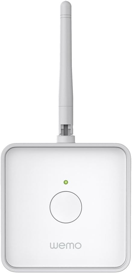

If you don't have a Rpi you could use a WEMO Maker
