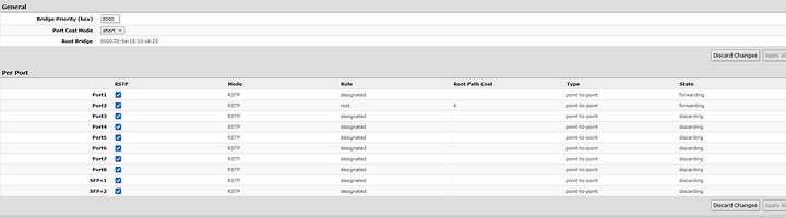

It does support RSTP, and this is how it is currently reporting without the redundant connections. Port 1 is router and port 2 is wireless access point. For some reason the wireless access point is the root?

I think I know the problem; according to Chatgpt, the wireless access point (WAP) is being elected as the root bridge. This usually happens if the WAP has a lower (better) Bridge ID than your other devices, including your router or core switches. I would change the bridge priority of the wireless access point higher than all the other bridge ports.
