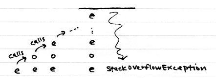

Recursion is stack bound via its return pointer and cannot be infinite, infinite recursion will be very fast at generating a stack overflow. XD
