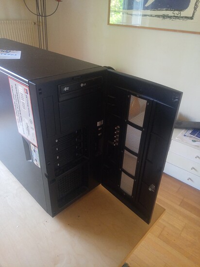

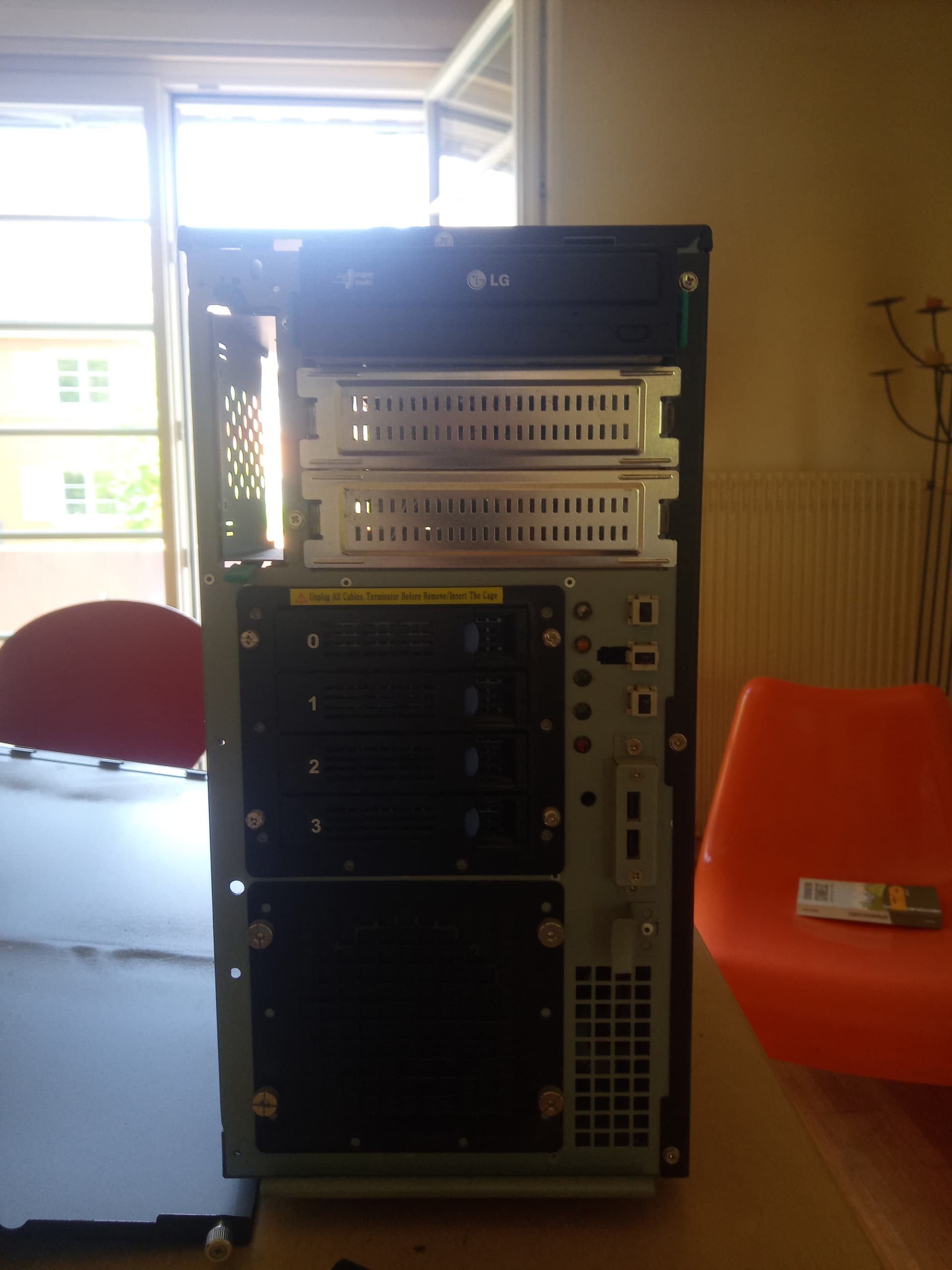

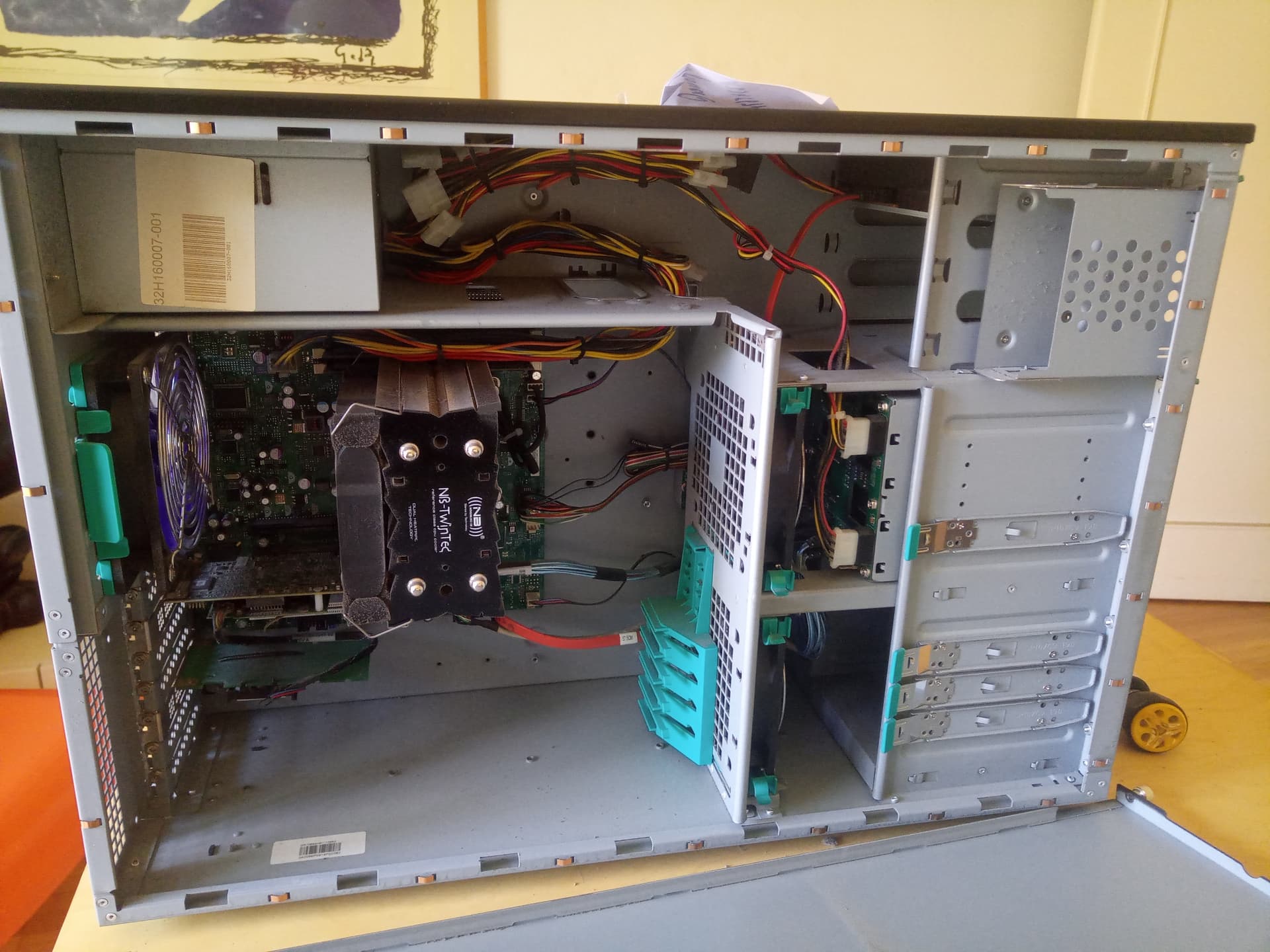

I got an old chenbro SR107 case that is also rackmountable from a local auction site for very cheap. It’s very a sturdy and heavy case, but the 3.5 hotswap bays are proprietary.
It’s very similiar to the SR107-PLUS case
