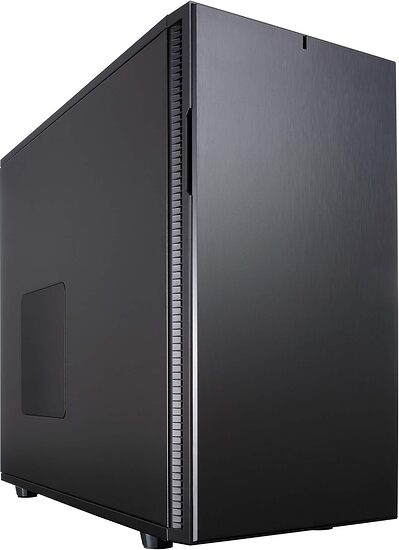

I wouldn’t spend “premium” on hotswap bays, spend that on a decent motherboard instead.
A Fractal Design Define R5 will do perfectly fine for instance
