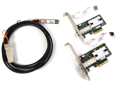

In order to connect two ends (one computer, one switch, or two computers if you want to direct link) you will need a network switch that has SFP+ ports, and a network card that has SFP+ ports as well, you will also need, for each port, one of these:
for 10Gbit, more expensive ones (way more expensive) for 40GB and 100GB, and all of the ā€˜pairsā€™ will need to use compatible ones (e.g., same speed)
If you have computers near the switch, you donā€™t even need the transceiver and can use TWINax copper cables, like the one in this ebay auction:
If, on the other hand, you have a computer that has already 10Gbit/copper (10GBaseT) you will need to use a cat6 copper cable to the switch, and use one of these:
The copper transceivers cost three times the fiber ones (but usually you need only one) and use way more power
