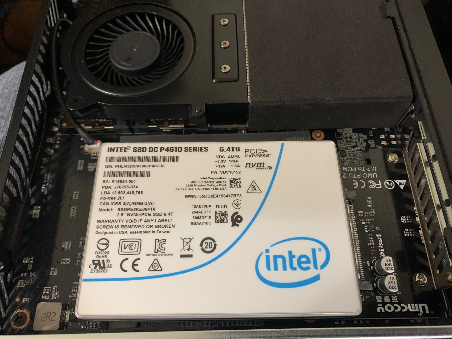

I found a 15mm enterprise U.2 / U.3 solution.
I’m using an 6.4TB enterprise Intel P4610 15mm U.2 which fits perfectly with this adapter in the x16 slot. This opens the door for 30+TB enterprise U.2 & U.3 NVMe drives in the Minisforum MS-01
What I did:
I had to remove the full profile bracket, place the low profile bracket into the MS-01 then insert the PCIe adapter with U.2 installed. Once seated in the PCIe x16 slot, I screwed the low profile bracket to the U.2 SFF-8639 card.
This adapter works perfectly for those wanting to add a standard 15mm U.2/U.3 enterprise NVME to their Minisforum MS-01. It fits lower than the fans so you can close the case & still have room for cooling without issue.
This is the adapter I purchased & tested:
U.2 to PCIe Adapter PCI-E 4.0 X4 to 2.5 Inch U.2 SFF-8639 SSD Converter Card. The seller Mu Ji Technology has these with both low-profile & standard profile adapter included.
