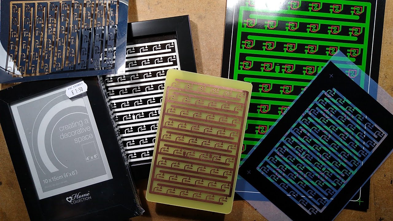

Point a shitty webcam at high-ish ISO at a board populated with color changing LEDs?
Similar to this system here but using this here:
The candle LEDs contain a logic circuit with that seems to be psudo-random.
[Can’t post my link, made a new forum account today]
Measuring the entropy for a static LED would theoretically be better.
The timing in the self contained blinking LEDs is widely inacurate. So in an 8x8 grid, you would quickly get completly random drift. Question is how you turn that into a useable value.
