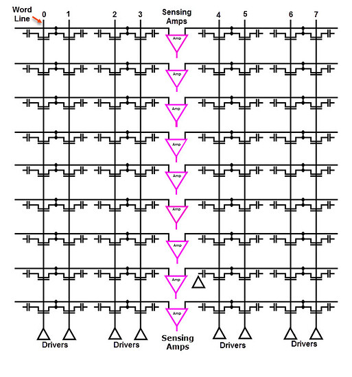

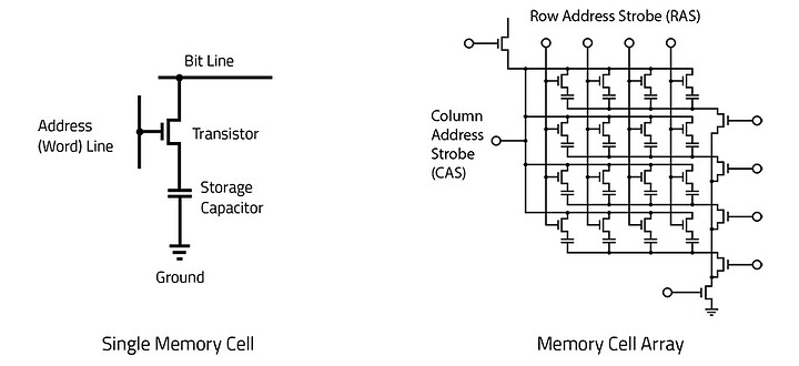

DRAM is a capacitive device.
That is, a DRAM bit cell consists of a capacitor that is either charged to a high voltage (1) or charged to a low voltage (0).
Unfortunately being capacitors, these cells loose their charge quite quickly, it drains away again through various effects. So the charge in the capacitor needs to be copied and ‘refreshed’ with it’s own value both when being read or at a set interval to ensure the bit is not lost. In fact this is where the Dynamic aspect of DRAM comes from, it fades and needs to be refreshed. It is not fixed like Static SRAM that uses switched transistors.

Now when a cell is read, its stored energy is actually depleted and needs to be recharged, so there are transistors and latches arranged around a sense amplifier that keeps a copy of the cell contents and refreshes the cell after being read. In addition there is a lot of logic for address encoding & decoding and helper circuitry.
The thing is there is a lot of peripheral circuitry assembled around the actual capacitive cell that is not so tolerant to increasing voltage and is also more prone to interference, and other electrical effects.
