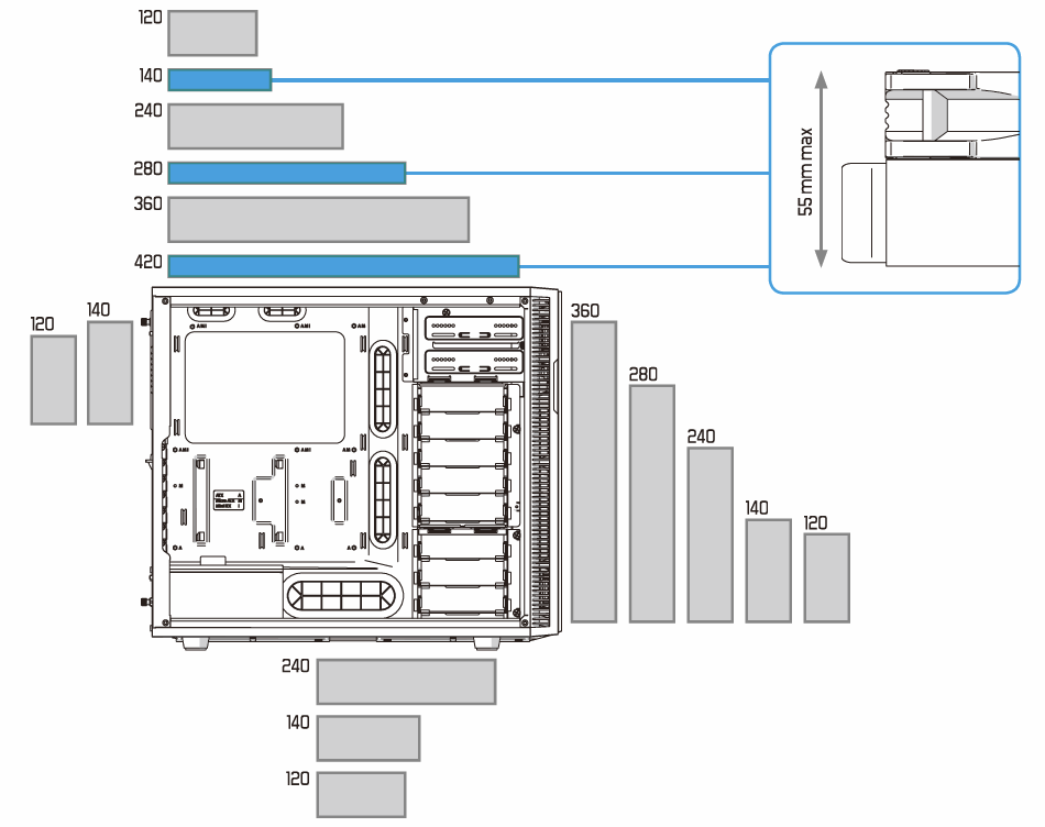

I'm planning a water cooling build in my trusty define r5 because I'm so fucking original and I was wondering whether to go with a slim 420 or a big fat 360 for the top radiator. Also I'm planning to use the SP120/SP140 from corsair or the venturi fans. What should I go with to get the best temps? Any suggestions for other setups are also welcome.

I would go with 420 for one reason and one reason only. R f-ing 5... Once you remove those panels, you need something to cover up those holes to stop the dust coming in. Larger fans will cover most of the ugly a** roof...
Also, thin can allow for push pull with stupid low speed fans, making it quiet as f*ck...

I'm also gonna get this btw: http://www.demcifilter.com/p0564/Fractal-Design-R5-3-Vent-Top-Dust-Filter.aspx to cover up. But yeah kinda sucks that i have to remove those panels but I wanted a 240 in the front AND this 420/360.
Probably gonna go with the 420 because of lower rpm. Didnt even think of that..
Maybe I should get a different case which isnt stupid about putting radiators top but they're all ugly or dont have any space..
